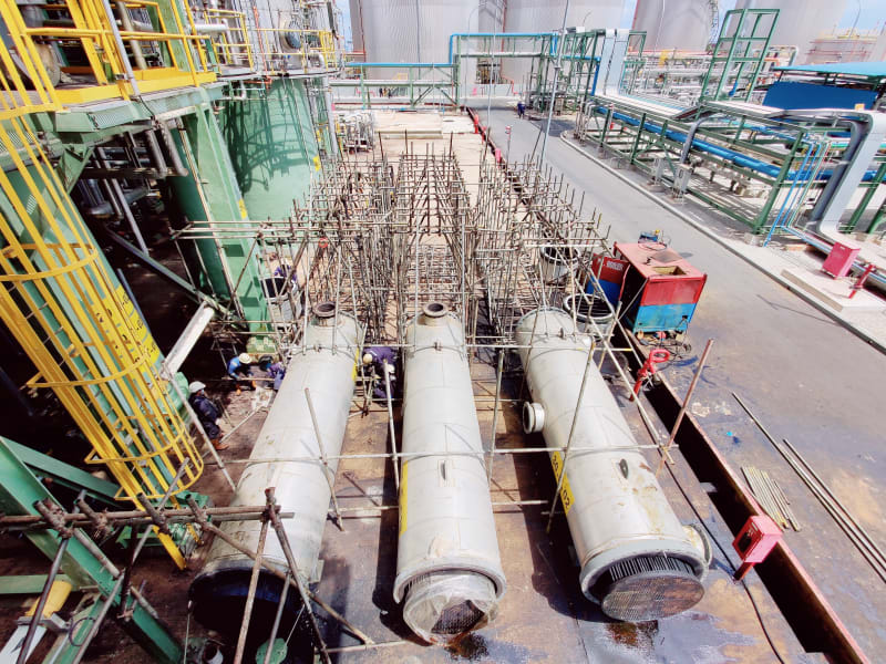

Ok LittleInch some pics as fun part even though I still hv no idea how to deal with it. I soaked with diesel, no success, I used chainblocks and forklift to pull with an impact but not 1 mm moved.I used 160 t crane as fix point and a 16 t forklift.......no chance. The coke residue basically were up to 20 micron fine solids which agglomerated when solvent was removed and is became solid rock. Hydro jetting an drilling was necessary for the tubes. Some tubes took hours to clear. But now I need to get the bundle out to clean the shellside and investigate the cause of damage. The attached pics are basicall the downstream hx which we were able to pull. Enjoy the pics.........
Btw. I was thinking of putting it vertically on the tube sheet and pull the casing like a sleeve just to break it loose. But it is also an expensive job as eqipment etc is difficult to get here in Batam island. It is also not the safest way to stand it up.
This was the first trial to pull and set it on the scafflolding
This was second attempt with tightening the strut bolts and press it into the shell (from floating end). 4x4 was bent and we used small hydraulic jack....Failed

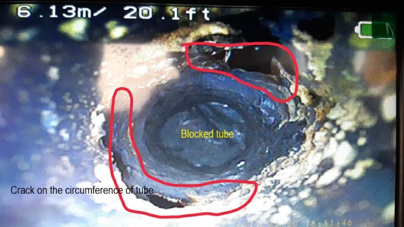

This is a leak and it looks tube is torn on the circumference about 270 Deg. Th end shows the coke blocking the tube. Please note, this is 25.4 x 2 mm SA179 and we hv no corrosive fluids and pressure is below 6 bar.
So it can only be thermal stress due to expansion problems ..

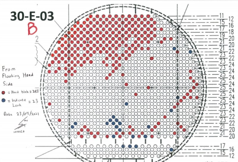

Update on cleaning process Blue tube have been found leaking
Red tubes are blocked and need manual drilling. Hydrojetting 15000 psi cant get it out
1. pass is solvent vapor in tubes - 2. pass is condensate (last 4 bottom rows).
Will take another week to get it cleaned in the tube side.
