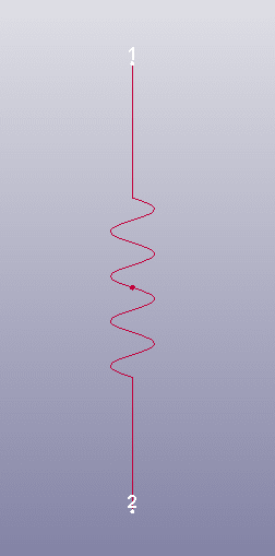

I’m trying to understand how LS-DYNA SSD Module works. For this purpose, I’m solving a simple mass-spring system from a textbook.
I tried to solve it with two approaches:
1. Time-domain: The result matches very well with the book.
2. Frequency-domain (SSD): unfortunately, I could not replicate the same result. I could not figure out the possible problem. I used enforced displacement by the large mass method. I put both models in my google drive:
Could you help me to understand what my mistake is?

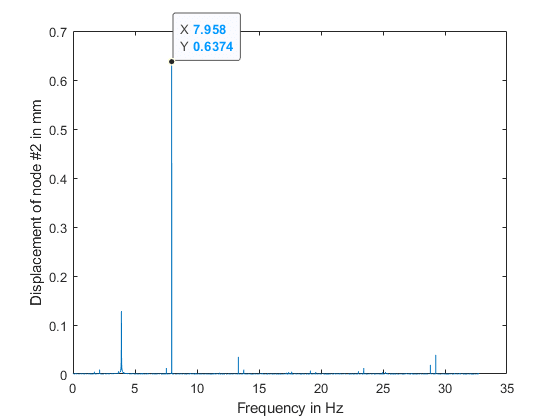

I have just one excitation frequency; therefore, I expect to see just one number: the displacement in steady-state condition on node 2. The result should match the textbook (0.632 mm)
When I use the base displacement method, everything is just right.
Hier is the result of the base displacement method.
Frequency----------Amplitude-translational-z-disp @ 2
7.96E+00 ----------6.32E-04
Your comment about the transient response is absolutely right. An FFT analysis is showing that very well.
