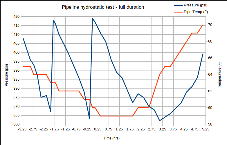

Hi all, I'm looking for a second (or more) set of eyes on some pipeline test data. The pipe in question is approximately 600ft of 24", mostly exposed except for a 30' section.
Here is a chart of pipe temperature and pressure for the last hours of the test.
Some of my own observations:
[ul][li]Recorded pipe temperature reached a low of 59F at .4 hours, and rose back up to 60F near the 2 hour mark. I'm guessing the pipe reached an actual low around the 1.25 hour mark and temperature started climbing back up after that. Per my own understanding, it would be generous to say that the lowest pressure should have been 386F if everything was okay, and should have started climbing from there.[/li]
[li]As pipe temperature climbs, pressure continues to drop until 3.2 hours on. The temperature is 64F at this time, and my calculated pressure is around 468 psi. Actual recorded pressure is 362 psi.[/li]
[li]At the end of the test, pipe temperature has risen 10 degrees F, but the pressure has only now gotten back up to what it was at the time the temperature started going up.[/li][/ul]
Is anyone aware of a way that the data could look like this without it indicating a leak?
Pipe dimensions are expanding faster than fluid volume with temperature.

I haven't reviewed many of these, but have seen some. In other tests I've looked over, the response has been fairly immediate- when pipe temperature goes up, pressure goes up. When it goes down, pressure goes down. To my thinking, this isn't just a short duration discrepancy when something wiggles on the test, it's over a period of four hours. And it doesn't disagree with the calculations by just a little, it's off by 200 psi by the end of the test.

Here is a look at the data over the full duration of the test. This includes the time before the last injection, while pipe temperature was measurably dropping. Over this period, the pressure drop rate is a little more steep than the allowable predicted, but not wildly off.
So really it lost 150 psi.

Start to finish, disregarding the injections, yes, about 150psi sounds about right. Steel pipe, .375 wall.
My bad- I got lazy after seeing how hosed-up the overall data looks, and didn't work the details on the injections. The first injection was 7.78 gallons, second one was 6.2 gallons. Fill volume is 13716 gallons. So by my calculations this would put the final pressure closer to 300 psi low rather than 200 psi.

Well, when you run the numbers it's not actually too far off for the fall off in pressure vs temperature change to it not being a leak, but it looks like the surface temperature rise has not occurred over a long enough period to allow the water temperature to catch up. Also there is no mention of what the initial WATER temperature was. The water has a very large thermal mass compared to the steel and will change slowly. If it wasn't exactly 65F at the start then all bets are off as this can't be accounted for properly.
From the graphs you can see than min pressure is 3 hours AFTER min temp. The pressure graph is starting to climb fast when the test ended and if allowed to finish or stabilise at 70F the pressure would have quickly got to the point where you needed to remove and measure the water to prevent overpressure.
This test is a farce - at no point has sufficient time been allowed for such a large volume of water to stabilise in temperature or pressure.
However you can say that the pipe has passed its "strength" test and clearly not failed, but you cannot show that it has passed the leak test as neither the temperature or pressure stabilised enough to be able to draw conclusions.

I was too lazy to do any calcs, but LI, you could be right. If you assume it is stabilised at 3.0h, it could be OK. Does it track dP-dT closely for those 2 hrs? If so, then if the test was allowed to continue for 8h after stabilisation (another 6h), that might have proven as OK. The problem is getting anything to stabilise with 600ft not buried. But being unburied allows you to easily get visual confirmation of no leakage, so that kind of overrules calculations anyway. 8h is usual minimum for pipeline work, so not enough time to qualify for that.

There is no record of the initial water temperature, I assume it was somewhat warmer than 65F. I did take a look at average water temperature over time when I started trying to understand what might have been going on. I ran two cases, one with initial water temp at 65F and one at 80F. I can't say that I went in depth into it though. I'll go down that path some to see if it might give a plausible alternate explanation for these numbers.

The test was for leakage, 49 CFR 195 E. I will say this- if this data is acceptable in anyone's book, I don't really see the point in the tests. If they accept this, they'd accept anything, so why bother?
