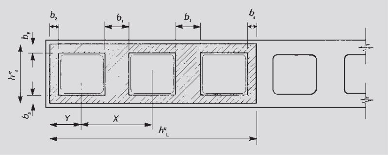

Is it possible to design a multistorey building to NCC 2019, governed by EQ, constructed with reinforced masonry (ie 190 block) that is taller than 15m and has a mu = more than 1.0.
I am just trying to gauge what the general consensus is among peers and industry so thank you in advance for any long or one word answer replies.
I should mention I appreciate the NCC requires ties and AS3700 assumes vertical bars can be restrained by an annulus of grout.

For clarity - the NCC requires ties and you can't rely on on the grout annulus as per AS3700 (I'm not sure if that is what you are referring to above).
While I have no Australian Masonry experience...
In NZ the masonry code has no height limitations for masonry structures provided you undertake the appropriate capacity design if undertaking a ductile design. There are design rules for confining plates in the compression regions of centrally reinforced walls that act to achieve the required confinement. These are a plate with voids aligning with the cells that are cast into the joints to effectively do the same job as closed ties
Having said that I've never seen anyone ever attempt a ductile multistorey design though and used these, but if you were after inspiration to actually do the design perhaps adopting the NZ standard instead of AS masonry standard is an appropriate approach. My understanding for ductile design AS3600 allows the use of NZS3101 for example.
