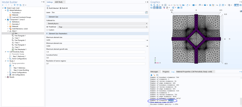

How can I see how many DOF's (Degrees of freedom) I have?
tugni925
Sep 14, 2020
107
NO
It says my number of elements are 243413 - does this mean my DOF are the same number? Is there a way for me to see how many DOF I have?
no, this looks like a 3D mesh, so 3*the number of nodes
In Comsol you can check the number of DOFs by clicking Study —> Show Default Solver. Then right click on Compile Equations for particular study step and choose Statistics.
