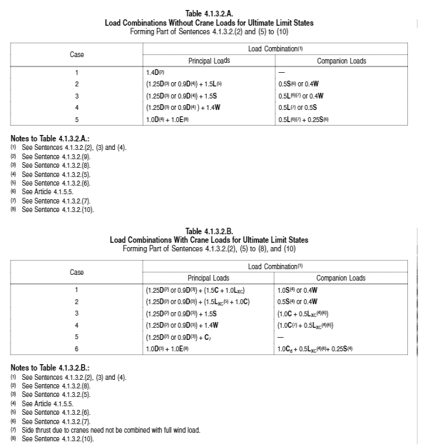

To our Canadian friends who might or might not be ignoring this: how do you guys handle these? One, you guys are used to lots of snow calculations, and two, it seems everything in Canada is Limit State Design (more or less equivalent to our LRFD).
In my experience up here in the frozen north, we do much of what has been indicated above, we use our judgement where possible to eliminate the load combinations that will not govern the certain scenario we are reviewing. Our typical load combinations look like the attached screenshot(please note this is the 2010 edition, not the current 2015 but it's what I had available at the time). As a note, we always consider snow drifts.
