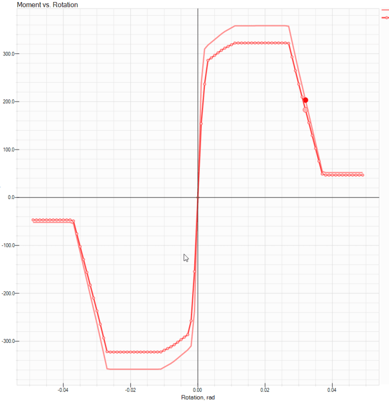

Can anyone please tell me when it comes to moment curvature analysis why do we focus on the strong axis of the walls only? Don’t we need to examine the displacement capability of the wall in weak direction more? I understand that the moment in weak axis can be ignore but the point of moment curvature analysis is to check the member’s displacement capacity and since the wall connects to the diaphragm that will drift in both direction, why don’t we check the moment curvature of wall in weak axis (out of plane) direction?

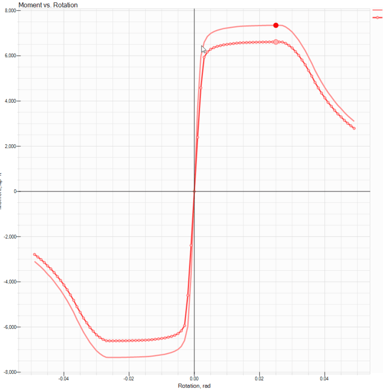

It's a good question that I have wondered about myself. I built a 20'-0" long, 1'-0" thick wall with #5 at 12"oc, to aid in discussion.
Below is the moment rotation curves that I get with 0 axial load on the wall:
Strong Axis
Weak Axis
I want to build a model to confirm, but my guess is that typical loading/wall arrangements will never be able to develop 200kip*ft of moment in the out of plane direction (appears to be approximate onset of rebar yielding from the graph). I would guess that the wall just lacks enough stiffness to develop that much moment.
