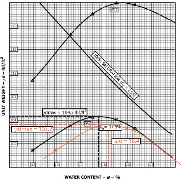

fattdad, if I understand correctly, you are suggesting to do the lab proctor curve on the fill sample. Then, say, at the end of the day, do a single-point proctor measurement on-site, followed by some sand cones. Then compare the sand cones against this value? The reason for doing this is to control variability of the fill soil? The shape of the proctor curve would be assumed the same as previously determined in the lab, but it will be transposed onto the nightly single point measurement?

a lab proctor is accurate for that sample only. Small changes in clay content, grain-size, etc. can affect the ultimate MDD. If you take a sample from the field and run one point on the field sample, you can walk that proctor point onto your lab curve and see if it falls reasonably onto that lab curve. You MUST do this on the dry side of optimum, 'cause they all merge together on the dry side.
Let's say the field point plots below the lab curve. Just translate the lab curve to the new point and get a new MDD. You must translate along the line of optimums (parallel the ZAV).

fattdad, I think I understand. If you look at the graph below, let the black line be the multipoint lab proctor. The field sample is done, and is represented by the orange circle. The proctor curve then shifts along the ZAV line until it meets the field sample (orange curve). The new maximum dry density becomes 103.2 lbf/ft3. The new optimum moisture becomes 18.4%. Sandcone test would then be compared to this new MDD, and not the lab MDD.

Hi Azza, Yes, you're example is my approach. The shift is along the Line of Optimums, which is how you drew it.

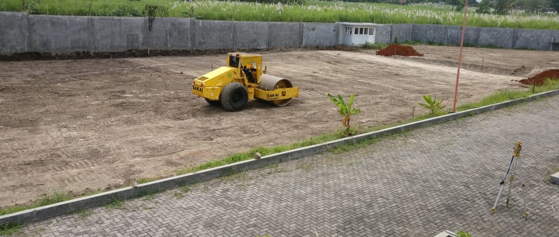

An update and a question.

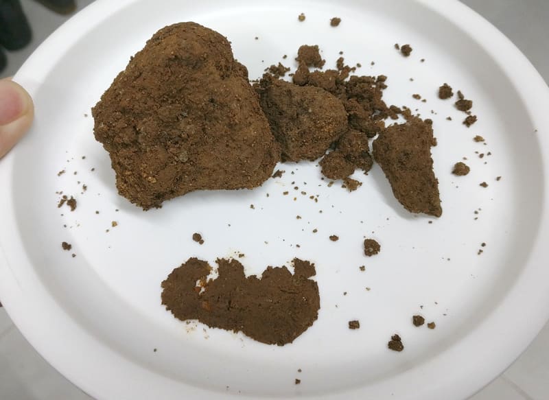

Stripped the vegetative layer with a dozer, then 30cm more using dozer + excavator. Placed the borrowed soil elsewhere on the property. Underneath removed material could observe traces of a previous fill with gravelly clay and some natural soft black silt. Proceeded to compact this surface with a vibrating roller (this is the only kind of compactor I was able to source, given the limited supply of heavy equipment).
Just as we were preparing to start the fill... it rained. A lot. The whole field turned to mud. It's been 48 hours since, but still not dry due to cloudy weather.
Question: what is the best way to proceed?
