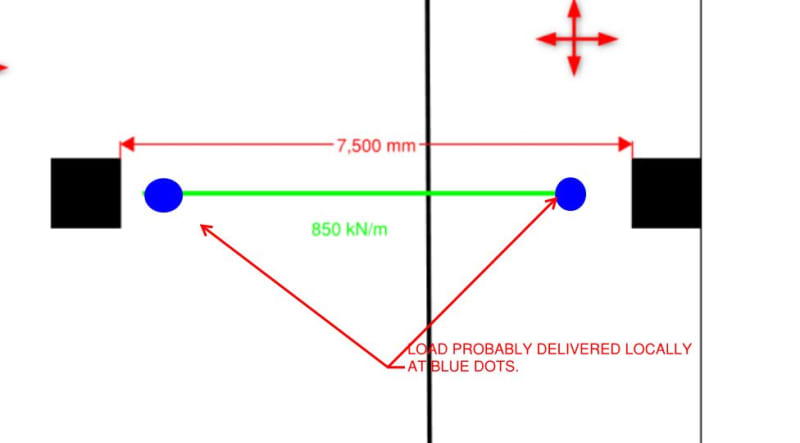

Please review the attached sketch.
I am curious to see what others would do to check shear in a situation like this:
I would think that one-way shear would also be quite critical but cannot find any guidance on what effective width of slab to consider.
Thank you in advance.

No transfer column.
It's a wall transferring along the green line.

I agree with KootK - as you have a 700mm/800mm thick transfer slab, walls that terminate within around 500mm distance to the column face will mean the majority of the wall load will be dumped within 'd' from the face of the column. Most national codes will give you a one-way shear enhancement benefit in this case. Essentially the load tends to strut itself into the support. See Eurocode shear enhancement provisions below.
When the wall stops greater than say 500mm from the column face, then you could think of a "hidden" beam within the two way slab equal to the lesser of the width of the column slab strip or say column width + 600mm (effective depth 'd') either side. Then you could apply the one-way shear provisions and design beam links as required.

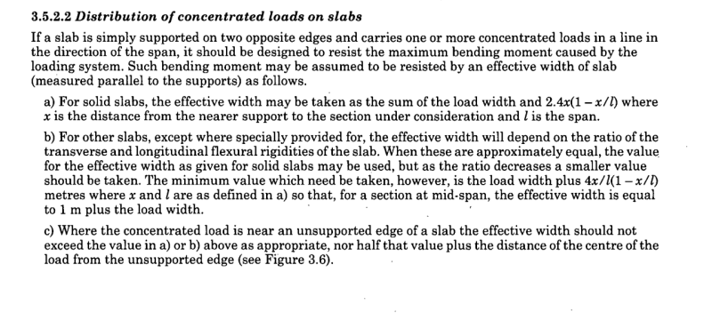

Trenno, it is the width of this hidden beam that I am most interested in.
I am unsure about whether taking the column strip would be unconservative. For bending I am taking a much smaller thickness, based on this (found in BS8110):
And taking x at the middle of the wall.
What is the thickness of the wall? What is the wall height? How many floors is this wall supporting?
I would say the wall will span between each end if it's tall enough. Assume the wall reaction onto the transfer slab acts over a length of 4 * wall thickness. This "hidden" column base within the end of the wall will be your new concentrated load location. You could then use your british code width equation with "x" being the distance from the centre of the "hidden" wall end column to the centre of the support column below.
200mm thk wall; 3m; 10 levels
The "hidden" column approach is interesting.
What I am conscious of taking an overly narrow depth leading to an overkill of shear reinforcement.
Though probably the same can be said for going too wide and providing too little.
Engineering judgement comes into play here. It seems you're not too far off an answer.
Say your shear load is around 7m x 850 kN/m / 2 = 3000 kN. Let's say 3MPa one-way shear is the upper limit, then you're looking at width of around for 1500mm for the 700mm deep slab. This isn't accounting for shear enhancement. The shear links required for this indicative situation aren't unexpected and would appear reasonable.

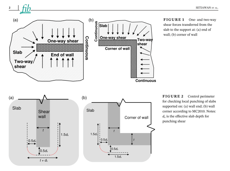

I think you need to check punching shear at the wall-ends with critical perimeter as shown below..
The clip below is for slabs supported on wall, but I think it is applicable for slab supporting a wall. You case is just upside-down.
The need to check punching shear around the columns is obvious.

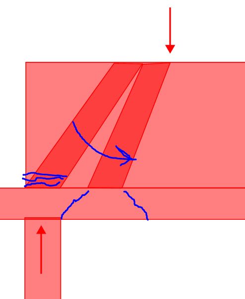

Yes. This is what happened at Opal tower in Sydney. There were bearing failures at the wall ends (which sat on columns) and then some punching failures at the blue dots as the wall settled. Good times :)

Tomfh, shouldn't you expect bearing or punching problems, not both? That is, bearing problems if you assumed distributed support, or punching if you assumed concentrated support at the columns.
If the wall fails in bearing at the columns the load can start going through the slab instead, which can punch/shear.
That's interesting Tomfh. This is kind of what I'm imagining. Although it's probably less a case of the strut migrating but, rather, expanding to achieve sufficient bearing width until a bunch of the load has to transfer over via punching shear rather than direct strut delivery.

I'm picturing that they assumed the load/reaction was along the wall length so would have designed for punching shear. The bearing failure was a stiffer but unconsidered path, otherwise they would have provided adequate bearing. So, one or the other unless something else is at play.
steveh49,
I would assume they treated the wall as a beam carrying the full load to the support and would not even have considered punching shear. And as a deep beam they had to consider the compression strut coming through the wall onto the column below.

Re punching shear, here is a guidance based on EC2, which is very similar to what hetgen showed:
