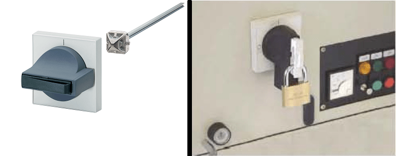

Appreciate the response. We switch off the MCCB via the rotary handle on the surface of module which is coupled to MCCB and we put a lock on it (something like the picture attached below).
The two main concerns are if MCCB malfunctions and doesn't disconnect the supply and technician doesn't notice or worse if after disconnection, MCCB malfunctions and somehow allow the electricity to flow the maintenance technicians are in great life-threatening danger.

If the MCCB doesn't disconnect the supply then it is faulty and needs to be replaced. As Brain says, the first thing you do after locking it off is to test the contacts by taking the JB plate off or checking that it doesn't start.
How exactly an MCCB which is locked off as you show can then reconnect the supply is not a credible event. If you're trying to eliminate things like that then I think you've gone too far into the realms of what if...

a) where there is a [local isolating switch]: Switch off the MCCB, lock+tag the MCCB handle in the off position. Switch off the [local isolation switch]. Open the cover to check ensure that both the [incoming and outgoing] terminals are dead. Cover the switch and lock+tag the handle in the off position. Attn: The door shall NOT be able to open when the handle is locked in off position.
b) where there is no [local isolating switch]: Switch off the MCCB, lock+tag the MCCB handle in the off position. Withdraw the withdrawable unit to the withdrawn position. Lock+tag the mechanism to prevent it from moving to the [service] position.
