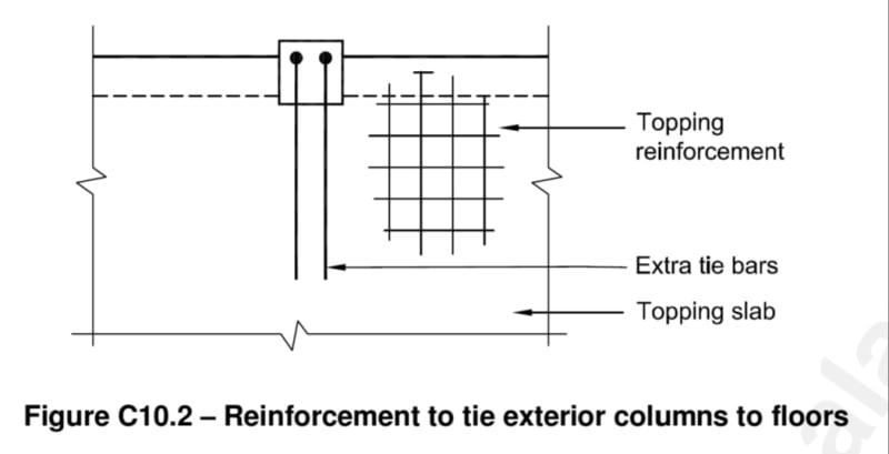

1. Would it be reasonable to extend the tie reinforcement a lap length inboard from the slab edge, in order for the reinforcement to be of sufficient length to allow effective dissipation of the design tensile force within the diaphragm? Or would you extend to the next column grid?
2. Do you confine this tie reinforcement over the width of the edge column? Or is there some flexibility to locate beyond the column face?
3. I suspect the horizontal tie reinforcement will need to be in addition to any existing flexural reinforcement?
1. Depends on the load, they are asking you to transfer the force. So you need to engage sufficient diaphragm reinforcement. Review using strut and tie unless your diaphragm reinforcement is higher quantity than your tie. I suspect in most practical arrangements a development length won't cut it.
2. I've always considered the reinforcement needs to go into the column. We wouldn't really consider it a good detail to tie into the potential hinge region of the edge beam. But I guess some judgement can be used provided you can demonstrate a strut and tie mechanism to engage some proportion of the reinforcement being placed just outside the column.
3. I've always considered it as additional to any other requirements. But I'm not 100% sure. Obviously if you have excess flexural or diaphragm reinforcement you can utilise anything over the requirement.
Will locate the tie reinforcement over the width of the column and extend it far enough into the slab to mobilise enough diaphragm reinforcement. To determine the amount of diaphragm reinforcement engaged, thinking of a strut and tie model where say a 45 degree strut angle fans out in two directions starting from the termination point of the tie reinforcement back towards the slab edge. The number of bars contained within this fan strut zone determines the diaphragm reinforcement that has been engaged. Does this sound reasonable?
Also, just playing devil's advocate here, but surely there would be instances where the 5% load is low enough that you could justify the load path without having to even rely on any supplementary tie reinforcement. For example, you would simply rely on the longitudinal column reinforcement passing through the joint to transfer the load directly into the slab (via shear friction), not dissimilar to anchor theory where the shear is transferred directly into an unreinforced slab. Of course I appreciate you would possibly have edge distances, cone breakout failure modes etc to contend with here. What are your thoughts on this?
Yeah more or less, but you will need to consider development past the nodal zone typically in strut and tie, in practice this just means fan out from the point where the tie reinforcement is fully developed (not the end of the bar).
