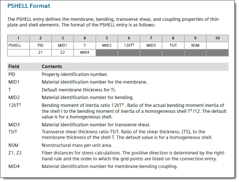

The Simcenter Nastran PSHELL entry defines the membrane, bending, transverse shear, and coupling properties of thin plate and shell elements. We use the PSHELL entry to define the material ID for the membrane properties, the bending properties, the transverse shear properties, the bending-membrane coupling properties, and the bending and transverse shear parameters. By choosing the appropriate materials and parameters, virtually any plate configuration may be obtained.

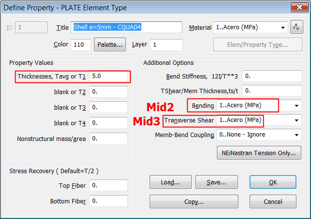

The CQUAD4 element can model in-plane, bending, and transverse shear behavior. The element’s behavior is controlled by the presence or absence of a material ID number (MID) in the appropriate field(s) on the PSHELL entry.
• Use MID1 if you want to include membranes only (no bending).
• Use MID2 (and optionally, MID3) if you want to include bending only.
• Use MID3 to have the Simcenter Nastran software use thick plate theory, which includes the transverse shear flexibility, to develop the element stiffness matrix. In general, for thin or curved surfaces, you should not use MID3.
• Use MID4 to input a coupling relationship between the in-plane forces and bending moments. This coupling only occurs in plates that are non-symmetric about the neutral plane or where the neutral plane is offset from the grid points. Typical applications include reinforced skins and aluminum bonded to fiberglass. You should leave the MID4 field blank if the element cross section is symmetric.
For a solid, homogeneous, thin, stiff plate, use MID1, MID2, and MID3 (all three MIDs reference the same material ID).
Adding transverse shear flexibility means that using MID3 adds a shear term in the element’s stiffness formulation. Therefore, a plate element with an MID3 entry will deflect more (if transverse shear is present) than an element without an MID3 entry. For very thin plates, this shear term adds very little to the deflection result. For thicker plates, the contribution of transverse shear to deflection becomes more pronounced, just as it does with short, deep beams.
The following image is from FEMAP to define the plate properties for 2-D Shell CQUAD4 elements:
