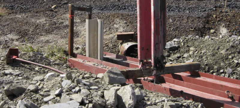

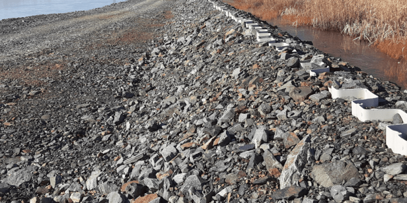

I have records of a vinyl sheet pile wall constructed for a flood containment reservoir with 20 foot panels and having no issues. The panels were pushed through a swamp and refused on dense till or bedrock.
We also recently pushed steel panels in a nearby location with similar geology and the steel panels refused on dense till and bedrock. Problem for us is the steel wall is supposed to be used as a retaining wall and the embedment is not sufficient in all locations.
GeoEnvGuy: please take no offense, but the 20 foot number just doesn't sound right at all. My experience with FRP sheet piling (stronger and stiffer than vinyl) is about 10 ft max of unbalanced hydrostatic load. Would you mind showing details or simple calcs or pictures of what you're talking about? Did this installation you are referring to actually "see" the design loading? Vinyl certainly has its place in the market - mostly for 4ft to 8ft stub seawalls in the bay, but my experience is that it is oversold for taller walls and higher-load applications. But I'm listening...
Hi ATSE to provide more context thon the 20 ft section I have include pictures below. The vinyl sheet pile wall was constructed to maintain the pore pressures outside of the reservoir (right side of photo 3) so that the inside (left side of photo 3) could be excavated to form the reservoir. The vinyl sheet pile wall is not used in a retaining wall application without the support of rockfill. In the design flood conditions the inside which is typically a lot lower could overtop to the vinyl sheet pile wall in a rockfill channel section.
how did you place the rock without damaging the piles?
