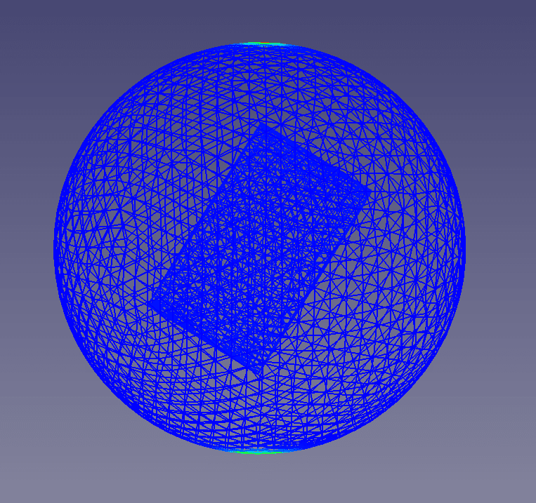

What I want is something like this: eliminate corners as suggested. Here is a quick simulation I made using a cylinder void instead of a cube void, with a static compression test, and visually it shows that the stress distribution doesn't creep near the void when there is significant thickness. I still don't have the knowledge of how to accurately model dynamic impact tests for fracture toughness, for example, if this were a drop test.

what shape do you want ? cube or cylinder ?? A cube with sharp corners should show more stress concentration.
What if you modelled your void as a sphere ?

even in compression, I suspect the sphere breaks by (tension) rupture around the diameter (normal to the load axis).
I suspect that this void has little impact on the load capacity of the sphere, maybe 10% reduction ?
the orientation of the void would have a 2nd order effect.

If the fill material has a poissons ratio of 0.5, like most rubber like materials, then it is practically volumetrically incompressible, and so can't be ignored. It will have a stiffening effect.

but I think a key failure mode is tension along the diameter perpendicular to the load axis. Then it volumetric constraint of the "void" is less critical (tho' important in any case) then the connection (glue?) between the "void" and the body.
A different poission's ratio for the "void" filler would have interesting effects.
