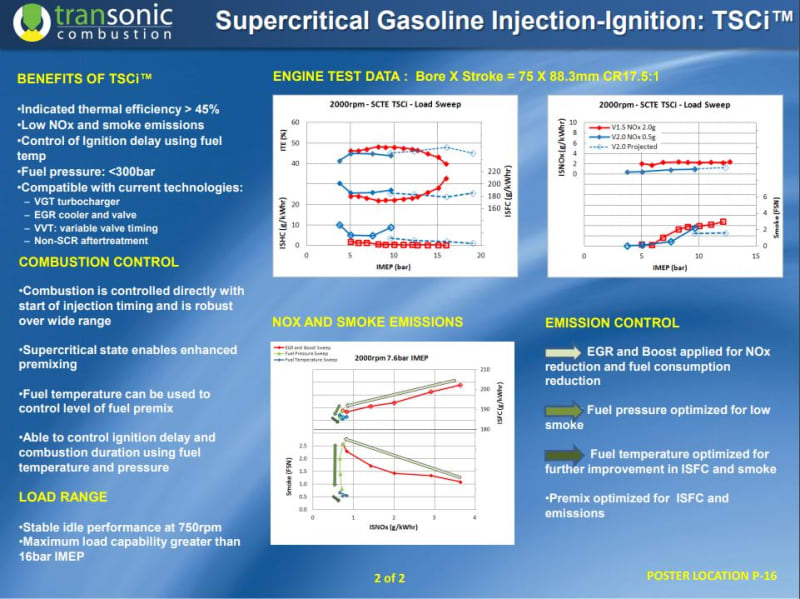

Smokey's patent discussing heating the fuel air charge sounds like a modest form of supercritical fuel injection.
P.S. Though transonic is out of business, the topic of supercritical fuel injection remains active
see for example
