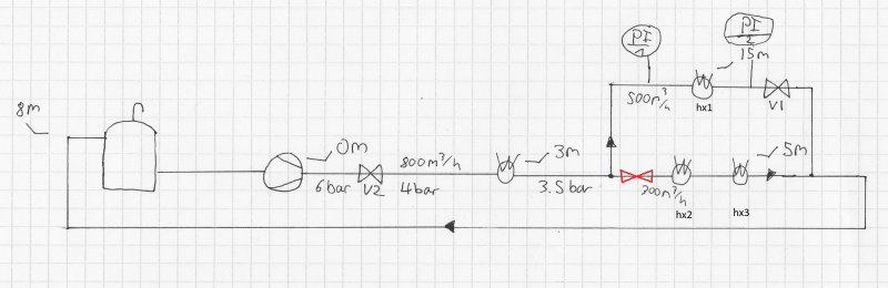

Hello,
we have the following problem: A heat exchanger (15 m) is fed by a pump (0 m). It is a pipe network where other heat exchangers on parallel pipes are located much lower. The pressure gauges read low to negative pressures right before and behind the heat exchanger. Throttling behind the heat exchanger seems to solve the problem. It is suspected that the flow stalls after the heighest point of that branch of the piping system. Nonetheless the flow rate through that branch is higher than through the branch that contains the other heat exchangers, located lower.
1) Can anyone direct me to literature or suitable key words for google, to get more information on the problem of the flow stalling? We suspected because the flow experiences a free fall and accelerates the vacuum in the heat exchanger is created.
2) Another mitigation which was thought of: install a throttling valve behind the pump before the pipes branches in order to increase the pressure. The increased pressure should make sure that the 15 m heat exchanger is supplied with medium. My questions here are:
2.a) The pump head matches the pressure losses of the pipe network. If I install a throttling valve the pressure will rise, but only before the valve. The increase in pressure should match the pressure drop across the valve. So in my opinion it is not possible to control the pressure in the pipe network with this method.
2.b) I am correct in assessing that the pressure at branching point does need to be greather than 15 m + pressure losses across the pipe + pressure loss across the heat exchanger. I suspect this does not pose a problem as long as the pressure loss across the other path is high enough. This would lead me to think we can ensure proper operation by throttling in the branch where the 15 m heat exchanger is NOT located.
Basically I'm trying to determine at which points we can try to control the flow in a manner, where we have no negative presssure at 15 m.
I'd appreciate your input on the situation,
have a nice weekend!

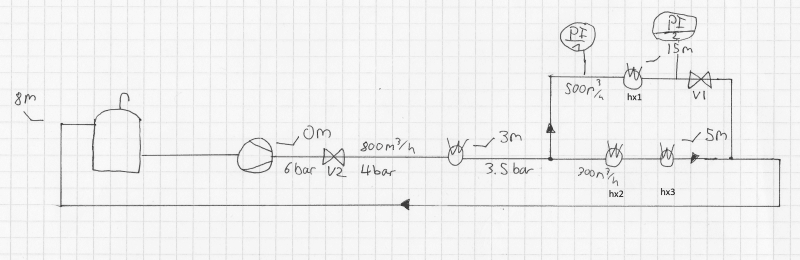

Thank you all for your input! I also realized prior to looking back at this thread that my post may have been confusing and I wasn't wrong. Let's start again.
This is a recirculating loop, the tank is vented if the symbol I drew there isn't clear.
This is the current situation and I supplied all information I have. Pipe diameter is DN500, exception: the two branches containing hx1, hx2, hx3 are DN200. The overall length is a couple of hundred metres. I don't have an isometry at hand. The medium is water.
1) The pressure indicators PI 1 and PI 2 indicate negative pressures and hx1 is often damaged. We suspect due to the vacuum occuring there. The idea here is that due to the free fall D/S of hx1, the fluid accelerates and the flow stalls. I'm an ESL speaker, so I don't really know how to describe this better. If 500 m^3 / h go in and the fluid velocity increases, then more than 500 m^3 / h would need to flow D/S of hx1, unless the wetted crosssection in the pipe decreases. This should reflect my original question 1), I'd like some further information on this phenomenon or at least a better description so I can find out myself.
2) Throttling V1 seems to solve the problem or so have I been told. If the acceleration / stalling theory from 1) is correct I can understand this.
3) The current idea is to use V2 to control the pressure U/S of hx1. This is where I have the most trouble in understanding / I'm opposed to the idea. I think every increase in pressure due to throttling V2, let's say the 6 bar rise to 8 bar, wouldn't change the fact that we still had 3.5 bar U/S of the junction point. All "extra pressure" gets dropped across V2.
4) In order to control the pressure U/S of hx1 I'd personally install an additonal valve here:
While throttling V1 seems to work, it also decreases the flow rate and I think in order to make sure hx1 AND hx2, hx3 are supplied with the proper flow, you would need to be able to increase the pressure losses in that branch.
Basically this question is: How to pressure control U/S of hx1?
From what I already got as input, pressurizing the tank may also be an option? I'm not convinced V2 has anything to do with "controlling" the pressure. From what I think I know, the only way to increase the pressure at a certain point, is to make sure D/S of that point there is some increased. D/S of joining the two branches would also be a viable location for a throttling valve. In order to maintain / gain flow control capabilities for the two branches I'd prefer installation in either of the branches.
Thanks for taking the time to read and answer this!
Thank you for the nice diagram! Usually everyone asks so many questions and only get a long series of incomplete answers and it takes forever to figure out what is going on, if ever. This is great. I'll give you a star for that diagram. It is clear and now you will get some good and timely comments. I will start with mine.
1) you need more pressure at P1 and P2. Open V2 fully. Throttling V1 will tend to raise pressures at all upstream points, but will tend to reduce pressures at all downstream points. If pressure after V1 is reduced too much, you may reduce flow in the downcomer to less than full cross sectional flow, I.e. partial flow. If pressure is reduced lower than water's vapor pressure, water vapor, cavitation might occur there.
2) Throttling V2 will increase pressure at the pump discharge, but reduce pressure and flow everywhere else. That is not likely to be helpful, unless you want to reduce flow everywhere. The 3.5 bar will reduce, tending to cause more vacuum at all heaters, especially at hx1. By throttling V2, you might be reducing flow so much that pipe friction lessens, which tends to increase downstream pressures everywhere somewhat. That might increase pressures at P1 and P2 some, but presumably you do not want to reduce flow going to the heaters. This possible effect is determined by how your pump and responds to the lower flow (usually increases output pressure) and by how much pressure drop you get across V2 at the lower flow (less). You have to look at your pump curve and valve pressure-flow-position characteristics to know haw that will work, or won't work to your advantage at the heaters.
4) Adding the red valve and throttling there increases upstream and hx1 pressures, but tends to reduce overall flow in the system. It will also tend to increase that slightly reduced system flow going to hx1 and hx1's pressure, but it will also reduce flow and pressures at the other heaters. It could be helpful, if not enough flow is going to hx1, or if pressure at hx1 is too low. You don't ever usually want to increase pressure loss anywhere, especially with P1 near vacuum, so let's just say we want to increase pressure everywhere in the hx1 leg.
Comment:
It can be tricky to balance flows going to multiple heaters, unless you can achieve exact hydraulic equilibrium. As we know, throttling the new red valve, increases a reduced system flow to hx1 and increases pressures in that leg, but reduces flow to HXn's and the pressure there in their leg. You may be able to find the proper throttling point and still have acceptable flows going into each leg, but pressure in the HXn leg may suffer. If you have excess pressure in that leg now, you could possibly afford to throttle the red valve and reach a solution for both legs. If pressure in that HXn leg is minimal already now, then throttling the red valve will only reduce their pressures more. If that happens, you will probably be forced to consider changing the pump for one that can produce a higher discharge pressure at your 800m3/h flow rate. Adding a valve into each heater leg would not solve the problem, as I think you know. Each valve would fight the other. It can be tempting to try that, but in the end, it is not a solution.
Increasing tank pressure will only raise the pressure at every point in the system equally. That would increase the P1 and P2 pressures and all pressures everywhere, but accomplish nothing else. If low pressure at HX1 and/or cavitation in that leg is your only problem, it might solve your problem, but increasing all pressures is not ideal.
Adding a valve downstream of both legs would raise pressure everywhere upstream, but tend to reduce system flow. It could solve your low P1,2 pressure, but it would also lower pressure at the pump inlet, potentially causing NPSH trouble. If you would not get NPSH trouble, you might think about that, but you would not be able to benefit by balancing flows going to each heater leg, if you needed to do that.
I would recommend that you add the red valve, if possible. If pressures and flow going to the HX heaters drop too much, then think about a new pump, or trying to increase its RPM, if that is possible.

My take away from our exchange is:
- We probably have partial flow d/s of hx1
- Throttling V1 may mitigate the issues until it doesn't (throttling too much)
- Red Valve is a meaningful solution
- Red Valve + V1 may solve all problems, and may be used as pressure control
- V2 can still be used as flow control
- we do not want to use the valves we currently have at the Hxns
Most people involved in the project think that V2 can be used as a pressure control solution for Hx1 and right now I'm almost alone with my opinion that it can't be used that way.

LittleInch said:
Is is less total flow than 800 m3/hr (how are you measuring this flow?)
Yes, with the exisiting V2 we want to be able to supply less water in order to reduce the cooling duty of the heat exchangers. Flow is measured with inductive flow meters. My diagram is one single state of which I got the most information. Occasionally up to 1000 m^3 / h are used.
The main problem here is, that someone has to actually go down and adjust V2 in case the product gets too hot. To mitigate that the people running the plant usually just don't throttle V2 at all / very little -> product doesn't get too hot. Unfortunately that also prevents any meaningful usage of the cooling water.

LittleInch said:
Basically the key to all this is making sure that the pressure at all times in the highest part of the system is >0 barg. DO that and then you can play with other controls to control flow to your hearts content.
This is what I want.
I'll check next week if positioning a valve d/s of all Hx is possible and try to sell that one.
LittleInch said:
All the red valve would do is increase flow through HX1. Now that might be enough to raise the pressure to prevent vacuum conditions appearing, but if you already have too much flow through hx1 that doesn't solve anything.
Unless I also reduce the flow with V2?
Otherwise V2 for flow control in combination with the existing control valve(s) should be my only viable option?

I would use V2 to control flow through the pump, which will of course define system flow too. In fact I thought that is the "flow control" valve. If there is any other flow control valve, then you should try to use that one. Two flow control valves might fight each other, or work together, but it usually makes control more complicated. You should only control with one. Keep the other full open, if you can. Anyway, your pump will respond by adjusting discharge pressure to whatever new flow results. V2, or the other flow control valve, should be sized to allow you to flow at that rate that while not dropping the pressure too much (when the flow rate is 800m3/h-1000m3h). Thus, if pump and V2/PCV are sized and matched correctly, pressure out of the valve will be sufficient to move that 800m3h-1000m3h flow through the remainder of the system, preferably without cavitation at any point. Especially at the heaters.
As the system is right now, throtteling V1 increases pressure and reduces flow at HX1. That will tend to increase flow and pressure in the other HX leg. But it may reduce the pressure downstream of V1 too much, partially-full flow causing cavitation, cascade flow and vapor formation and flow instability, including vibration and noise, if severe. Installing an air valve there may not work well, because releasing anything, water, air or vapor there will only try to reduce the pressure there more. It will not increase pressure there and that is at least part of that problem.
An air inlet (vacuum breaker) valve there would try to increase the pressure to up to 0 barg, but then you will get air in the lines. Controlling 2 phase flow is a lot more difficult and full of potential instabilities. I would not do that, unless other solutions are not acceptable. Plus it might not increase pressure at HX1, only at the breaker valve itself and downstream. The addition of air changes the continuity of mass balance in that leg, so the hydraulics may be difficult to predict. And if pressure at HX1 does not increase, those damages might continue.
You will need to do an accurate hydraulic analysis to determine how to stop cascade flow, partially-full flow and cavitation downstream of V1, as there isn't much pressure there, so all little tiny pressure losses are important and must be accounted for in the analysis. If that is the problem. It may not be severe, but the flow is relatively high, so noise and vibration might be worrisome. If not, try to throttle V1 a bit and see how things respond. Some cascade flow may be acceptable and it will raise pressure at HX1 while reducing flow there, but it will force more flow to the HXn leg.

Absolutely correct IR. Generally that pump head would be enough to preclude cavitation anywhere, if the flow has not been increased above that used for the original design. Trying to increase flow rates too high above what the original design condition specified is the primary cause of these kinds of problems.
Big Inch, you're contradicting yourself.
Item 1 in your first reply I think is spot on "you need more pressure at P1 and P2. Open V2 fully. " and "Throttling V2 will increase pressure at the pump discharge, but reduce pressure and flow everywhere else. That is not likely to be helpful,"
But now you're saying use V2 to control the flow....
It's pretty clear now that this is not a system which has been designed properly so pressures and flows are all wrong and nothing matches or makes sense.
The ONLY WAY to make life better is, as you rightly say, more pressure at P1 AND P2, to maintain these above atmospheric pressure.
After you do that then just control each HX or series of HX on temperature.
You won't do that if you do anything with V2 other than open it up fully and control flow downstream of the HXs to raise the pressure upstream of this currently non existent control valve.
No contradiction. I am thinking about the appearance of that possible "other flow control valve".
Marcboc, some more info about where that other control valve is would help.
Is it FCV or PCV?
If you want flow control, the best place for that is near V2, or somewhere in that main line, the closer to the pump the better.
And where are the flow meters?
Lowering the system flow will have a tendency to increase pump head and reduce all friction pressure drops in the entire system, so average system pressure would increase with that and it is possible that P1 and P2 will rise with that effect. In fact I think that is what is going on now. Marc says that it helps some when you throttle with V1.
