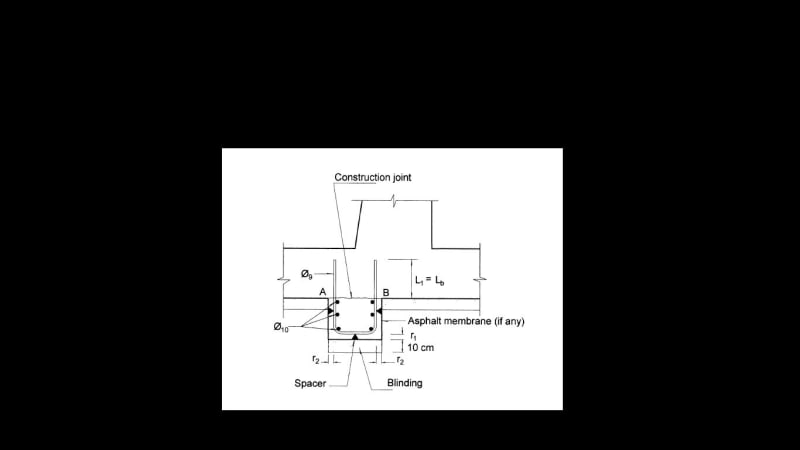

The following doc. is from CALTRANS ( free to download ) which explains the use of shear key for retaining walls..
And the following rebar detail from (MANUAL FOR DETAILING RC J.CALAVERA)

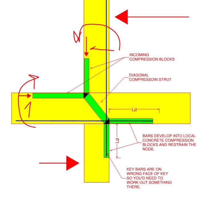

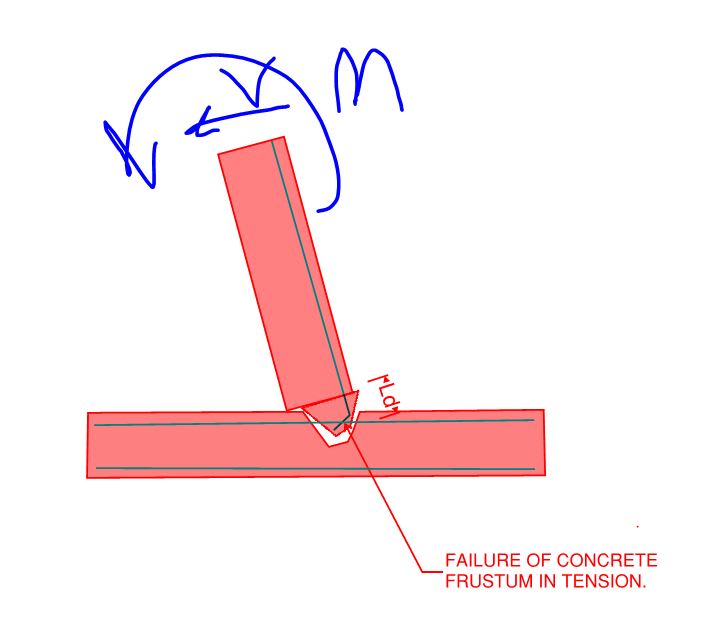

The error in that logic is failing to recognize the difference between rebar development and rebar anchorage. Development is a component of anchorage in most cases but, on its own, does not guarantee that the bars will not pull out of the concrete. And, even if it did, that's relying on concrete in tension for your primary load path which few engineers would be comfortable with in a situation such as this.
That said, I agree with you that your proposed detailing makes for an excellent moment connection. One of the best in my opinion. It just needs to be conceptualized in a robust manner as shown below. That leaves a few practical problems:
1) Constructability as mentioned by my colleagues above.
2) As shown, the rebar is in the wrong face of the key.
3) Whether or not this arrangement actually reduces your footing thickness is something that would shake out of a strut and tie analysis of the joint.

You could solve the problem of the straight bars out of the stem being in the wrong face of the key by moving the key back so that they're aligned in the front face of the key. However, then you're back to the issue of needing to reinforce the bottom of the toe another way, and the issue with keeping the vertical bars vertical is back in play.

No, not at all. Note that I said that we avoid using concrete in tension. Obviously we do all use rebar in tension. If the stem rebar tension is not either passed around the corner as rebar tension, or truly anchored (as opposed to developed), then one is relying on concrete in tension to prevent the rebar ripping out of the concrete and taking a chunk of concrete along with it. See the sketch below.

I never said that it was a constructability issue. I said that, as shown in my sketch, the rebar would be in the flexural compression face of the key which is clearly not correct from the perspective of the flexural capacity of the key.

The point that I was trying to make is that it is impossible to know if the footing will be 2" thinner unless one has actually done the strut and tie design of the joint to find out if that is workable. Since development does not equal anchorage, it is incorrect to assume that, just because you can develop the bars, you've got your footing depth sorted.
