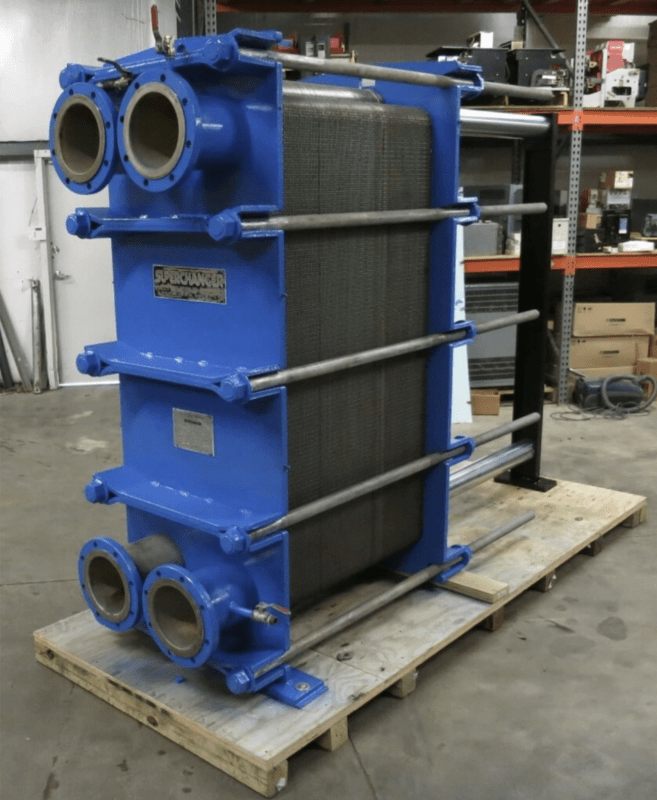

This is what the radiator on a ship looks like.
However, motor ships do often have waste heat boilers in their stacks. I have also seen engine cooling water used to boil water in evaporators.
Plate heat exchanger.
The term radiator like in a car, is not really correct as the heat exchange is more by removing hot air from around the fins, I believe. Air blast cooler is a better term.
