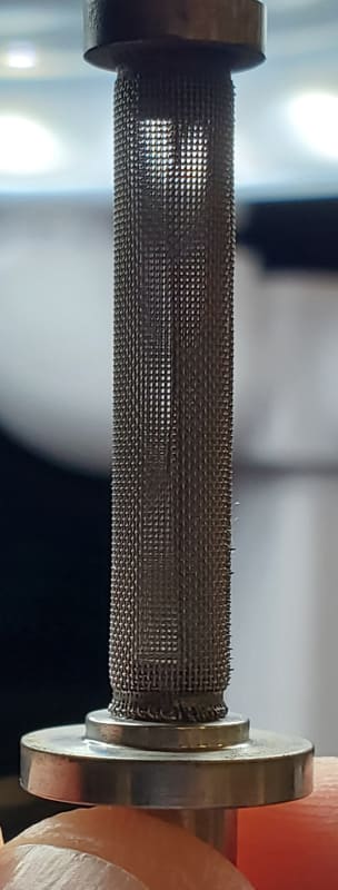

Howdy all,
I'm looking for alternatives to Dichloromethane (DCM)? We have a callout to clean the filter in an Starter Control Valve using DCM in a sonic cleaner. So this filter is on the upstream side of the starter valve and I'm guessing just used to prevent contamination of the regulator. DCM is difficult to procure and has environmental and safety issues. We have an ultrasonic cleaner using an aqueous cleaner or I can put the part in a ziploc bag with any solvent I want and put it in the ultrasonic tank. Are there any recommendations for an alternate solvent, or considerations about what I shouldn't use or specific contaminants I should be targeting?
Thanks,
-Kirby

It's an air-filter. So this is a Starter Valve, It's where the ground equipment would be hooked up to pump pressurized air to spin up a turbine to start a turbo-fan (CF6-80 on a 767) The valve is normally closed but opens when pressurized.
From the CMM:
B. The normally closed valve opens with supply pressure at a minimum of 11.9 psig when
the valve solenoid is energized with 28 vdc.
C. Servo supply air from the butterfly valve bore passes through the actuator supply orifice
to the closing actuator chamber. When the solenoid is energized, the servo supply air is
allowed to pass from the closing actuator chamber through the filter and through the
valve opening rate orifice into the opening actuator chamber.
The filter is a fairly fine wire mesh (all metal) that would strain out anything large enough to be visible without magnification that might prevent the regulator diaphragm from functioning at it's target pressures.
I think selecting a different solvent seems straightforward, but I wanted a sanity check to make sure I'm not missing some critical factor. I've asked Hamilton Sundstrand the same question, but they don't seem to respond to anything. I suppose I could replace the filter every time.

Is Your filter element 'simply' woven fine-wire mesh made from CRES, Cu-Ni, nickel alloy [Inconel], etc... or is it welded/sintered/braised/etc across nodes? IF simply woven, be cautious about indefinite re-use.
DoD bought-into the concept of woven wire mesh filter-elements for the ability to be indefinitely re-cleaned. HOWEVER it was discovered that that woven mesh is subject to micro degradation at the wire-crossing nodes... especially with entrapped contaminates, heat, vibrations and flowing fluids [including air]. Microscopic flexing/rubbing/abrasion/corrosion-erosion tends to squash/abrasively thin-down wires at the nodes. The first notable change was mesh stretching/deformation at these nodes] that often resulted in screen layers laying/rubbing on each-other [which sometimes happened when abusively mishandled by mechanics]. Also, determining WHEN the element is 'clean-enough' requires testing. I am trying to ID the USAF T.O. for filter cleaning for other hints... can't seem to locate it.
What does 767, CF6 data say about this topic?
Regards, Wil Taylor
o Trust - But Verify!
It looks like it's just woven. Here's a picture of the filter:
In pushing back I got our safety guy to okay purchase of the DCM. I am going to try and find a copy of the AIR787 and read it to learn more about filter element.

KW... That's a teeny-weeny filter element...

KW... BTW... looking closely at your good quality close-up photo...
Right side 'edge' of the filter element... near the flanged-base and up about 1/3... there appear to be some [4 or 5] broken or stretched or dislodged... wires.
I suggest using a soft white cotton rag, or cheesecloth, to gently wipe the exterior of the element... much like inspecting a flight control [wire-rope] cable. I have a bad feeling that the cloth fibers will snag on these wires... which is sign of deterioration.
PS. The following USAF T.O. for inspection/testing/cleaning of reusable wire filter elements was rescinded in 2002. I suspect the DoD finally realized that filters are cheap... engines are expensive.
9H3-1-1 Cleaning and Testing Instructions for Woven Wire Hydraulic Filter Elements
PS, The practical side of me want's to agree with you... grounding an engine for a tiny filter that could be cleaned seems really wrong. STRONGLY recommend You get spares in the pipeline ASAP... but prepare for temporary returns to service.

A standard polyethylene ziploc will have adequate resistance to dichloromethane, which used to commonly be call methylene chloride. Teflon is unnecessary. Acetone is often a good alternative solvent, but flammable.
Wil,
Yes, I noticed that too. I'll pull out my microscope to get a better look at it.
Compositepro,
I was seeing that PE was not resistant to DCM. I was going to check it to confirm regardless. If it lasts long enough to do a part it's good enough for me and much cheaper then a teflon bag.
