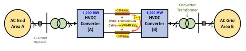

DC Current for Sizing the XLPE Cable
cuky2000
Aug 18, 2001
2,135
DO
Please help me out to verify the Max. DC Current for Cable Sizing.
I get 1875 Amps.
Am I missing something?
Bill
