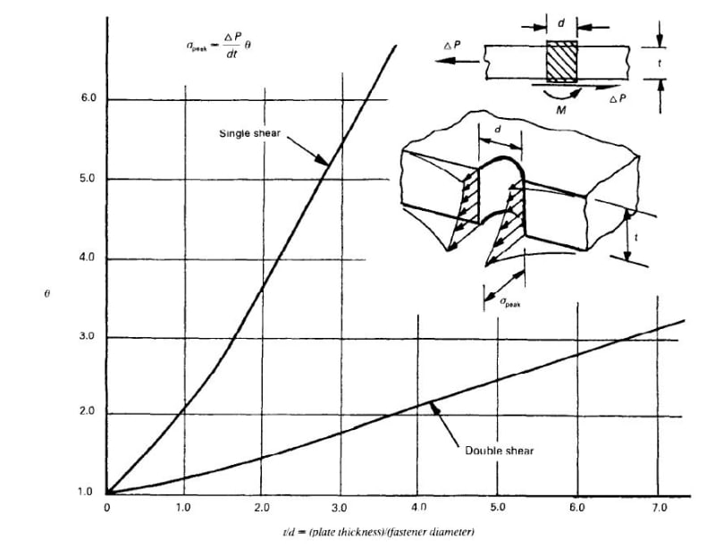

...more details of the design, a 1" wide flange of a unit 0.125" thick is fastened joint to a .071"2024-T3 Alclad sheet using AN3 bolt, and have been asked why material thickness correction factor (Kt) is not included. Never used this material thickness correction factor before for a joint(usually fitting factor 1.15 is the one accepted), using standard Bruhn approach for a combined shear and tension load of a bolt for a margin of safety. Didn't find any reference of it in Bruhn, Flabel, Niu, P.Safarian, etc... nor the NASA TM-2012-217454 Report. Loads are small and the joint is not fatigue critical and is not evaluated for that matter and I don't think this material thickness correction factor is related to a stress concentration factor, but you are right, shouldn't be called Kt, it creates confusion. No winning so far on this, that was the reason was asking for your opinion on this matter, sorry for the late respond, was busy day today,

Another consideration would be as follows:
The joint strength (ie load capability) of the fastener is actually dictated by many factors. The extreme limits of the strength would be simply plate bearing (Fbru*(t*d)) or each layer, and the shear strength of the fastener shank (Fsu*(pi*r^2)). However, neither of those are generally how an actual joint will fail. The reality is both bearing and shear (and tension) are happening simultaneously and the full bearing or shear strength is almost never realized unless the layers are very thick or thin relative to the diameter.
The actual failure regime is what we call "transitional failure", and if you are familiar with joint strength tables from OEM structural repair manuals you will recognize that term. These tables are general based on empirical data and you can tell pretty easily that the actual strength values are lower than pure fastener shear or layer bearing.

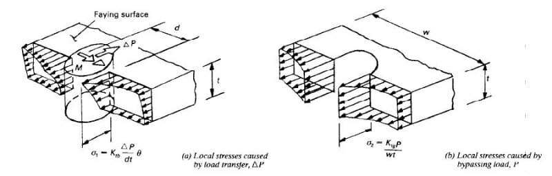

But why is this? Well, most joints have some amount of eccentricity causing the layers to deflect somewhat and also causing minute rotation of the fastener. This manner of deflection causes the fastener to impinge on the layers non-uniformly. This effectively reduces the bearing area to a value lower than simply t*d. The thicker the layers, the worse the reduction of bearing area.
One way you can account for this is by using data associate with the severity factor concept developed by Jarfall. As part of his work, he developed charts for bearing stress distribution factors that accounts for the actual profile of the bearing stress through the layer thickness. This inputs into the bearing stress Kt.
Perhaps, if you are writing a joint strength margin based on computed values rather than joint strength tables, the reviewer wants you to account for the bearing stress distribution to approximate the actual transitional joint strength?

Oo, thanks LiftDivergence, that's a good one, agree on your thoughts, and usually I am referring the joint strength data which is different than actual fastener strength, Boeing have a pretty good data, Northrop and Lockheed and MMPDS as well present these data. So, in Niu's first book is the one pretty close to my problem, he calls it bearing distribution factor which is directly related to the t/d ratio, and his graph (fig 7.7.27) proves it that .071/.190=0.37, so theta = 1.0 I think that's a pretty solid argument. Thanks a lot again LiftDivergence, appreciate it!!!
