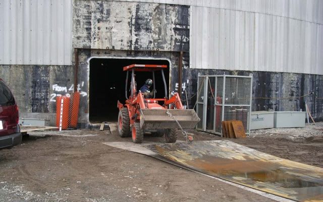

The new bottom is placed on spacer material ( sand or concrete ). A doorsheet is opened on the shell to take new plates etc. inside.

If there is substantial metal replacement and not just patches required then cutting a hole in the side of the tank will pay huge dividends compared to only access through a 30" or 36" manway

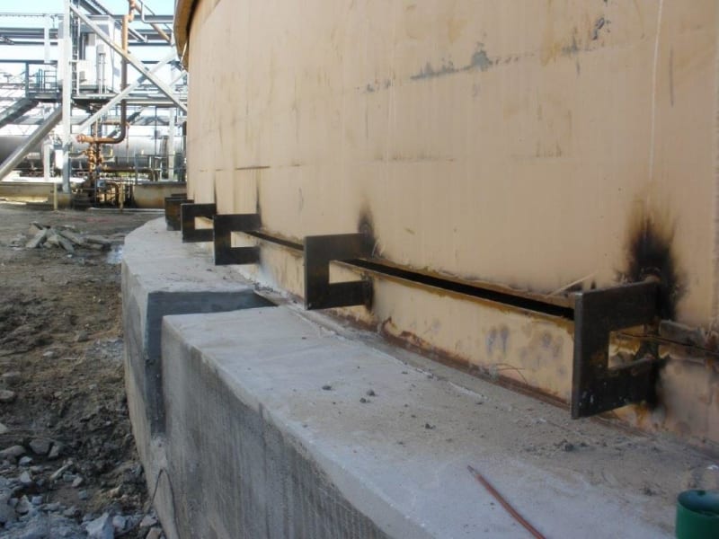

The tank fabricators will generally cut an access hole into the side of the tank to allow access for the replacement steel.
There are several methods to replace the bottom. Some tank fabricators will weld "C" clips on the base of the bottom tank sidewalls to hold the tank up and allow the bottom plates to be slid under the tank wall. After the "C" clips are installed, a torch runs on a track to cut away the bottom.

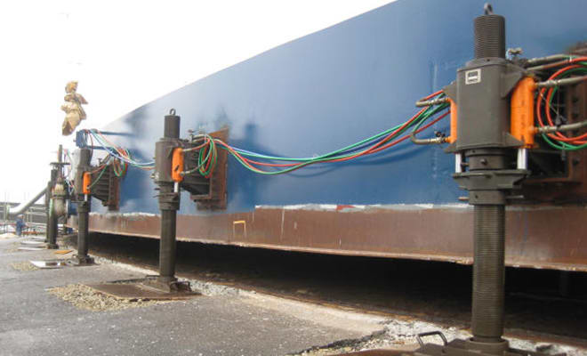

Another method used by tank fabricators is to jack the tank up.
The bottom ring will probably be replaced in sections rather than replacing the entire bottom ring at one time.
