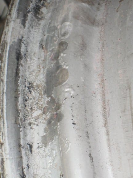

The rims on my 98 Mercedes started to leak a few years back. I had the old tires removed. After cleaning off the rubber sealant, I found several areas where the aluminum had bubbled and corroded. The interior of these rims including the bead area were factory coated with a brown paint/coating. Perhaps an epoxy. In sanding out the corrosion and cleaning up the beads seat, much of this coating was removed.
Problem now, is what to recoat with. Getting any coating to adhere to aluminum is not easy. But because the natural aluminum oxide protective coating has been removed, I believe that a coating must be applied. Just which one and how best to apply?

Yes I did test the rims before un-mounting the tires. I did not post the whole story in post #1. I used the bubble test and marked the rims where there were rim leaks. In each case, there was corrosion in the bead area. Back then I took some pictures (attached). I cleaned those rims up to bare metal. Then filled and coated them. Based on advice from a Mercedes "expert", I used a 1-part air cure polyurethane that is known to be effective when coating previously rusted steel. (An example would be POR-15) It forms a very hard coating. Problem is that it does not adhere to smooth surfaces. Requires some "tooth". I thought sanding with 80 grit would have provided that, but my coating did not adhere uniformly. Which it needs to do! I have installed aftermarket rims but would like to now restore the originals.

Sorry, I was being a bit snarky. You've decided you want a coating so your best route will be to sand blast, apply a chromate conversion coating or chromate-free primer designed for aluminum. A coat of surface tolerant epoxy on top should seal everything up.
I would avoid powder coating as it tends to lift off the surface and form pockets that cause crevice corrosion.
Have you confirmed the wheel is leaking at the bead? I have to repeat, the German wheels in those years we're very porous, whether chrome or paint, once the coating fails they start leaking. I suggested the Loctite 290 because with will fill and seal the porosity very effectively and can't chip or peel off. If any pitting from existing corrosion is deep and preventing the bead from sealing, a metal filled epoxy should be used to fill the pit.
I missed that these were aluminum - that isn't tooth that is the problem, it's that aluminum oxidizes very fast, forming a difficult to adhere to oxide surface, which as tugboat mentions, requires a chemical conversion coating in order to get most paints to stick.
