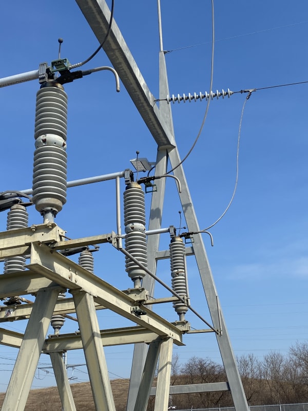

I don’t know much about the arcing horns, other than we remove them and the bus arrestors as part of a station rebuild. New Zno arrestors are installed on the lines. That smell of a new arrestor is almost sweet.
