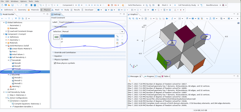

I am modelling a unit cell for a repetitive structure and then running a cell periodicity study to find the material properties. I have a model which gave me the correct output with another geometry, but with changed geometry I get this error:
The main thing I change in the model is the thickness (a) and length (l) of the "beams".
I have calculate the dimensions based the volume fraction of 0.2.
Please let me know if I can provide more pictures
This looks like a generic non-convergence error. It’s hard to say more without knowing the settings of this analysis but I would start from checking boundary conditions.
FEA way I have attached what I found under Fixed Constraint, tried to place it around the model but didnt seem to help much.
engineering_patrol, do I need livelink Matlab to see this stiffness matrix?
