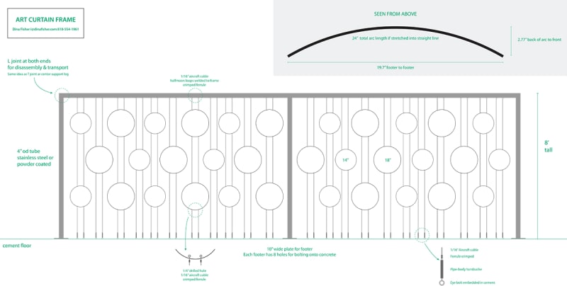

Here's a quick sketch of what I have in mind. PLEASE let me know of improved suggestions. I read elsewhere in this forum it might be smarter to use standard steel instead of stainless, to force the corrosion into the steel instead of the aluminum. I simply don't know enough about metals to make the judgement.

Answering Tmoose's questions about what gets hung on the cables, let me offer more details. There are actually two cables suspending each disc (I originally only described one being used, just to make the discussion easier). Each line of cable holds at maximum two 18" wide aluminum discs. The cable lines are stretched taught vertically between a cement anchor and a metal rail 8 feet above. These are not mobiles, it is more of an image "curtain" as pictured in the included photo.
