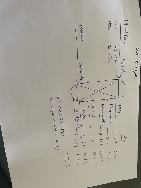

Feb 27, 2021 #1 Jone k Petroleum Joined Feb 27, 2021 Messages 18 Location OM In Hydrocraker unit, two stages and full conversion.we are producing Heavy diesel,Light diesel ,kerosene and naphtha. how we know how much we are producing a product and how much conversion for each stage from total feed.

Feb 28, 2021 #2 0707 Petroleum Joined Jun 25, 2001 Messages 3,445 Location PT You should have a manual of your unit which would explain that, anyway you should look to the behave of your catalyst it would say something about. Upvote 0 Downvote

Mar 1, 2021 Thread starter #3 Jone k Petroleum Joined Feb 27, 2021 Messages 18 Location OM it’s not mentioned in the process manual Here the image for first stage feed and conversion Upvote 0 Downvote
