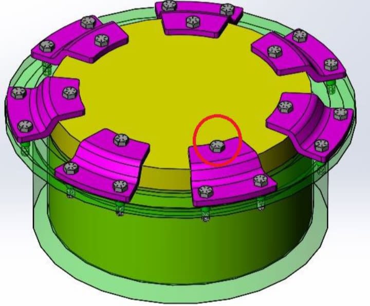

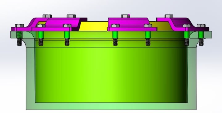

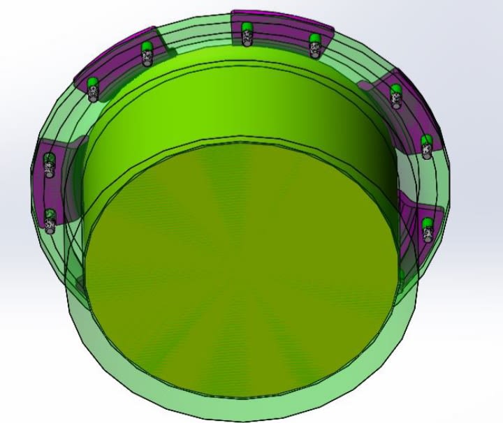

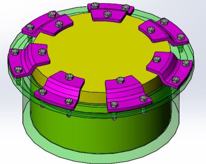

I am attaching pictures of a conceptual design.
The aim is holding the yellow inner part in place while the green outer part is held from its base and is subjected to accelerations and vibrations.
The aim of the purple parts is fixing the yellow part and minimizing (or avoiding) relative movement between it and the the green one.
If you ask why the purple part isn't a one piece the answer is an intention to save weight.
By the way, the radial clearance between the green and the yellow parts is 1 mm and it's filled with a cushioning silicon foam.

Another picture
If you see anything that isn't robust enough.
I was told that putting only one bolt in the indicated place in the picture below isn't enough because it may allow a relative rotation of the yellow and the purple parts. I am wondering if it's correct.
No, since you have two bolts attaching purple to green.

How are the purple parts made? Compound-curve bend will require special tooling if it's formed metal.
Purple is a machined part

Put a flange on the yellow part, and equally spaced bolts btwn. that flg. and the green part. That flg. might be about as thick as the pink clamp parts are, but this saves a bunch of bolts, much other work in manufacturing, and some more weight too. And, gives you a much more secure attachment, and makes things a little more water tight than the 1mm gap which you claim you have now. That is an overly complicated design for no apparent reason, except your CAD allows you to do it.

"I was told that putting only one bolt in the indicated place in the picture below isn't enough because it may allow a relative rotation of the yellow and the purple parts."
Is the proposed "answer" to relative rotation to put an additional bolt in each inboard purple tab for a total of two?
If the second bolts on the scene and their clearance holes are precisely located like the original six, then I don't see 7 thru 12 limiting motion any more than 1 thru 6 did.
Asking bolts/screws to resist motion simply by "being there" is just rooky unreasonable in my opinion.
Even "fitted" bolts are likely to have only 2 or 3 players on the team that actually make contact with their fitted holes.
And then there is the effect of male threads in female threads. If the fasteners are loose, the clearance between the pitch diameters is measurable.
If tighter, where will the centerline of the fastener be ?
If the fasteners are reasonably tight, then the friction at the faying surface around each and very fastener makes a useful contribution.

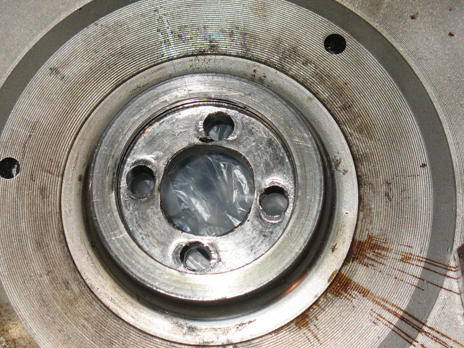

VW type 1 flywheel to crank attachment -
Even when fitted with twice as many 6 mm dowels, as in Porsche 356/912 engines, any deficiency in tightening the "gland nut" or faying surface irregularities or even operating abuse will leave the flywheel and crank to die a horrible protracted death.

The design has a lot of fasteners and I suspect this a) is not necessary, b) will cause frustration on the assembly floor due to torqueing sequencing and c) add cost to design & manufacture. If manufactured with clearance holes for fasteners and snug tight assembly, relative movement may be possible. It looks as though a clamping force is desired but doesn't appear this will be achieved. The yellow part may be pulled upwards.
Relative movement can be eliminated by direct mechanical connection such as yellow part with a flange as per dhengr's comments.
Indirect mechanical connection such as clamping to generate a friction force could help. Think over-centre clamp with a single fastener per clamp.

The purple thing should be a single ring stamped out of sheet metal that can probably be thinner than what's already shown and thus lighter, and if that's not light enough you can probably cut lightening holes in it now that you don't need to worry about each triangle twisting relative to the others. And maybe you can cut down on the number of bolts (inner and outer) now that you don't need to worry about the triangle deforming or wiggling out of shape.

I have difficulty believing a continuous thinner ring is heavier than 7 little clamps with 14 bolts.
Does the yellow thing sit on the base of the green hole or is it suspended by the clamps?
