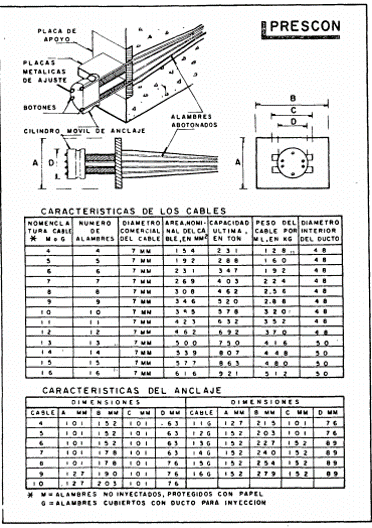

I need more info about the Prescon System just like the images in this previous thread. If anyone has the manual in PDF format please reply with the link to download it, it will be so helpful!

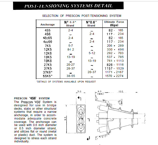

Thanks a lot! That will help me with my research. At first I thought Prescon only had the buttoned wire system, but I'm also gonna put info about the multi-strand system which uses 7 wires per strand in 0.5" or 0.6" diameter. Some of the information I have is about the anchorage system which uses multi-strands and the other one is information about the number of cables or wires (The second pic is in spanish as I took from a mexican university thesis, by the way, I'm a mexican civil engineering student about to graduate). If you could help me unificate this info, to understand it better since I will talk about both systems. By any chance, do you happen to have the full manual in PDF version?

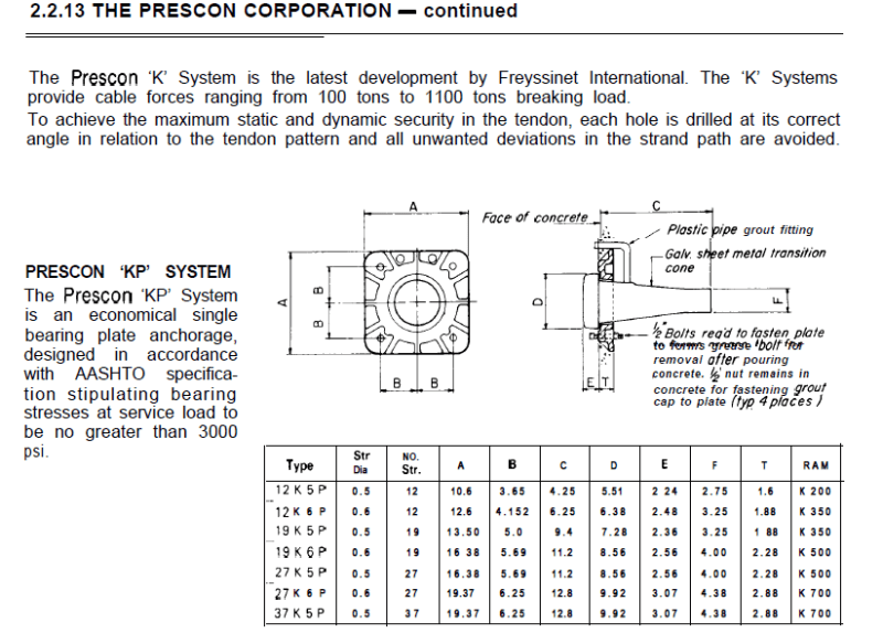

And if you could help me understand the nomenclature of the system from the third image, in Type chart I guess it is the following:
12 K 5 P where:
12 is the number of 7 wire-strands
K is the name of the system
5 is the diameter of the strands
P (I don't know what it stands for)
First and third image (From PTI Post-Tensioning Manual)

My understanding from your posted images above is that PRESCON has (had) two multistrand systems - the 'K' and the 'KP' systems. With the 'KP' being used for AASHTO bridges - so the 'P' nomenclature is just to distinguish it from the 'K' system.
