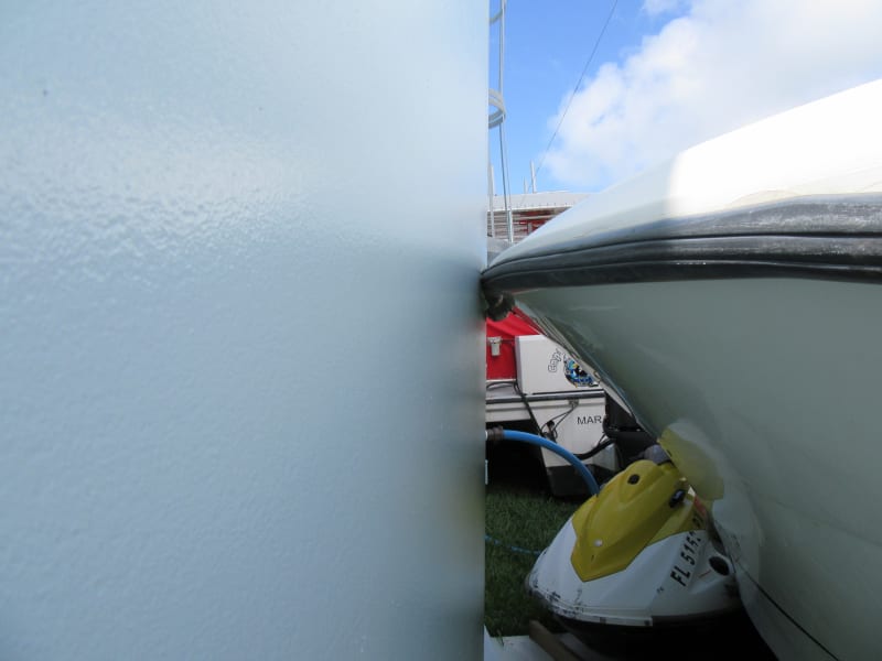

I used to think that concrete tanks were better for wind borne missiles (hurricane/Florida) until I saw a steel one in Key West Florida after Hurricane Irma with a boat resting against it .

Thanks for the insight and photo, JedClampett!
