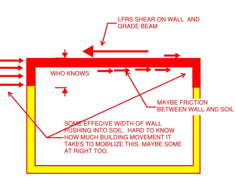

I'm currently responsible for the design of a manufactured home foundation, the client wants to have it supported by a perimeter grade beam which at the same time is supported by piles. I'm having a hard time coming up with a way to confidently analyze the foundation system due to several factors (bear with me as I'm not experienced at all when it comes to manufactured homes supported by grade beams on top of helical piles):
1. The home is comprised of basically 4 shear walls that transmit all of the loads to the foundation system, this means that wind and seismic loads act in an orthogonal direction to the grade beams, this induces torsion on the grade beams and I can't seem to find anything on torsion analysis for grade beams. On the other hand, I was thinking that an acceptable approach could be to have each beam resist the vertical loading of the shear wall on top of it but resist the lateral loads of the shear walls that are perpendicular to it, this would lead me to ignoring any torsional effects and go about a simpler design for it. I'm not positive on the latter though, is that a logical assumption at all to make in this case? (see attached sketch).
2. The idea of having a perimeter grade beam is to eliminate any lateral loading and moments from acting on top of the piles, the initial idea was to brace the piles with a cross bracing system but the client decided against it as they feel that it won't pass local jurisdiction (California doesn't seem to like non-concrete foundations). I'm assuming that, similar to isolated footings, a grade beam can be expected to absorb these loads without transmitting them to the piles, therefore having the piles only resist the vertical loading. Is this approach a correct interpretation of the load path for this foundation system? Or will the piles still receive any moments an lateral loads that go through the grade beams?
The usual load path story that we tell is that the grade beams resist only the LFRS shear forces oriented coincident with their longitudinal axes. And the vertical, shear wall chord forces of course. So no torsion on the grade beams. And that's a good considering how difficult it would be to detail your grade beam connections at the supports to resist any accumulated torsion.
Quote (OP)
I normally specify LFRS lateral loads acting on the tips of the piles which, unless they protrude out of the ground significantly, will not be cross braced. The sketch shows another load path story that I've seen told on many occasions. It's a bit dubious in my opinion owing to all of the unknowns and the need to shift the building a fair bit before the soil resistance is mobilize.
