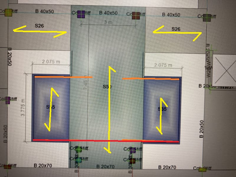

Hello all.
I was reviewing a concrete slab layout and would like to get your views regarding the load transfer mechanism here.
Will the cantilever slabs will be supported on the center slab here(this is what I presume)?
How much width of 500mm slab will be effective for carrying those slabs?

The distance from column center to slab edge is 550mm. So the width as per your recommendation will be 1100mm..
So I would design those 1.1m wide strips for normal moments from slabs and additional torsion from the cantilever slabs?
Also, cantilever slabs will be designed separately with fixed end right?

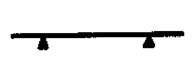

No need for torsion in the notional beams. Treat the cantilever slabs as having a backspan between the two notional beams - see the image.
This will stimulate the torsion in the S50 slab which will twist towards the loaded cantilever when only one is loaded. The nearer notional beam will deflect down and the opposite beam up just like the edges of the slab that the notional beams represent.

I just want to add, this slab system should be modelled and analyzed with FEM . Apparently, the deflected shape of S 50 slab will be cylindirical and the S35 slab will follow that shape. That is, the cantilever moment of S 35 will accumulate at two sides ( shown with red at the following sketch) so the cantilever reinf. should also be concentrated at two sides and span reinforcement in longitudinal direction should be provided.
If i were the designer, i would calculate the total cantilever reinf. for 3.75 w and distribute the top reinf 1/3 at two sides and 1/3 at middle and provide bottom rebar in longitudinal direction ..
The following sketch is for working directions of the slabs..
