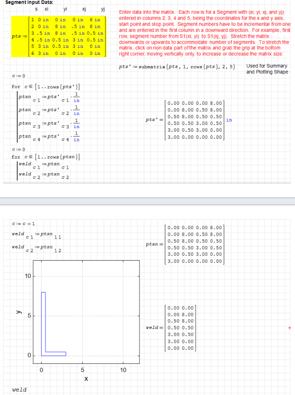

Is there a manner of removing the units from the array so that I can put the array values into the line data? I've tried about 10 different ways without success. Part of the problem is the unit values... Can the x and y axis be defined to show units? Thanks, Dik I'm trying to draw the weld shape.
Also the limits don't seem to work...
 https://files.engineering.com/getfile.aspx?folder=5d3fc9db-dff5-40df-9ef6-e5c5f2f8acb0&file=XYPlot_Test1.sm
Found a way... does anyone have an easier way? and does anyone have a means of establishing the range of the x and y axis? and the scale for the x and y axes.
