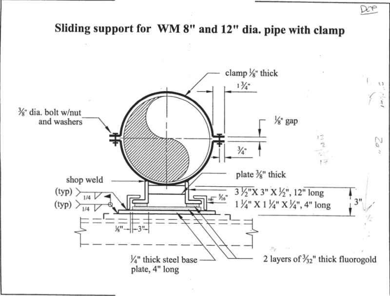

On bridges in NYC, the City requires steel pipe with an epoxy & polyurathane coating; all the joints are welded. The spec is attached for reference. We never hang the pipes from the deck; always put them on supports.
