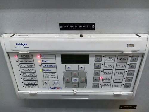

Hi
After a check we found that there is a difference in the setting of reverse reactive power and voltage in the AVR and the alternator relay as follows:
Alternator relay voltage max. 432 V
AVR voltage max. 440 V
Alternator max. reverse reactive power: -34.2 kVAr
AVR max. reverse reactive power as attached table.
Do you think if we set the max AVR voltage and reverse reactive power slightly less than the alternator relay this may solve the problem? e.g. 430 V & -33 kVAr
 https://files.engineering.com/getfile.aspx?folder=c7fab814-9fe7-4136-9dd2-c3c5688aab4c&file=AVR_reverse_reactive_power_setting.docx
Micom P40 Agile
From your photo the relay is MICOM/ P343 Gen Prot relay.
As I mentioned before it is having ANSI#40 loss of field relay.
There is no other function in the relay for reverse reactive power.
Therefore, pl. confirm,
1) ANSI#40 function is programmed in P343
2) The relay tripped by that function.
While running, this function looks after the generator from absorbing reactive power.
Because when the excitation DC field is lost while running the sync gen
becomes an induction motor and absorbs reactive power for its excitation.
