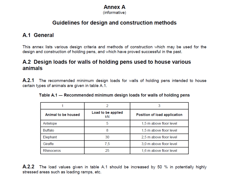

South African here, I recently did a project for a rhino and buffalo enclosure for a veterinary school and
we have a code or recommended design loads for such animals. This is from SANS 1184-1:2004
This is for temporary housing though.
SteynvW, thanks. Minor typo though: SANS 1884.

I suggest asking the zoo what to design for. I designed an elephant enclosure many years ago and they provided all that information. Don't quote me but if I recall correctly (remember this was 7+ years ago) the force was something like 10 kips on a gate.
for liability, it's good if they can provide the design loading...
