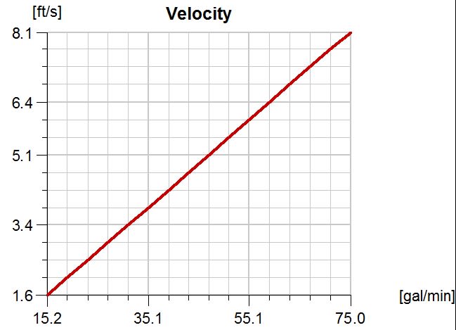

From memory, you wont get more than approx 8:1 turndown with vortex meters, so you'll need at least 2 vortex meters piped up in parallel to get 70:1 or so ( a low range and a high range meter). Plus you'll need an inline densitometer for mol wt correction to give you a corrected standard volumetric flow readout.
To elaborate on vortex, at low flow, there aren't enough vortices generated within the 'reporting' or update time period, so vortex meters report zero flow, a self induced low flow cutoff. Rule of thumb is about 10% of max flow is the low flow cut-off, but it depends on the pipe size and flow, but it's a physics thing that all vortex have to deal with.
Beware. Note that the origin point of a typical sizing chart for the design conditions is not (0,0); the flow cuts off in the example at 15.2 GPM, any lower flow rate is reported as zero.
georgeverghese,
I think you are correct from what I have read up on the vortex meters.
danw2,
Thank you for elaborating on why the vortex meter is probably not suitable. I found a less expensive model of the one we originally purchased from the same company so I think I'm good for my gas flow measurement needs.
