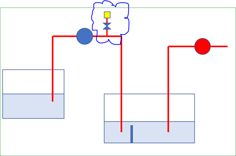

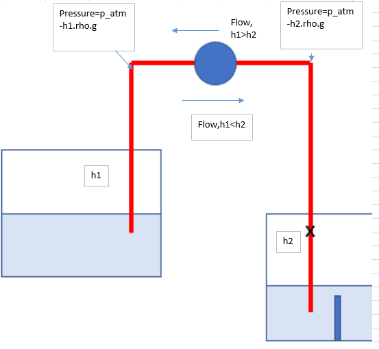

We had recently changed our pump (for our effluent system) from a screw pump (BLUE PUMP) to an air operated diaphragm pump. Simple setup.
When we stop the diaphragm pump, the discharge pipe maintain its syphoning effect and still pull the effluent from the suction side (due to the level in Pit 2 and RED PUMP running). We do not want to drain the effluent in Pit 1 to dry.
Most simplest option is to drill a hole (or installed a vent) at X, inside pit 2 but way above the bottom of the first pump discharge.
What's your thought?
Just place a vacuum valve at the top of the loop downstream the blue pump which will stop the syphon.
It's basically nothing more than a spring loaded non return valve.
I don't think your idea would work as its too far away from the peak negative pressure in the syphon
Vacuum breaker valve at pump level should work but you also need a foot valve at bottom of pump inlet pipe otherwise you may lose pump priming.A small priming tank at pump level may also be needed to take care of leakage thru the foot valve.

A foot valve or non return valve would help, but given the blue pump is a diaphragm pump it should be self priming, especially if the lift is quite low.
Just cut off some of the inlet pipe so it does not reach below your minimum level mark.
You can also use a full port solenoid valve in the pipe. If the system is automatic, connect the solenoid valve so that it operates when the air pump is operating.
Thanks all for the quick feedback.
Will the arrangement below work using a Vacuum breaker?
Agreed.. pink star for this simple but neat, working solution..
As long as you don't mind getting sewage sprayed on your face as you walk by. You mentioned "effluent system" which indicates that this is a sewage application. Vacuum breakers are not recommended on sewage because of the potential for failure from clogging.
If you cut the pipe the outlet end may be above the downstream tank level (possibility). If it happens the pipe may become empty due to back flow. It is doubtful whether the pump cam pump out air to create vacuum for priming(it is only an assumption).

Just put a full bore ball valve in the line and wire it so that it opens when the pump is running and closes when the pump stops.

searching for "sewage vacuum valve" seems to show the valve vendors do specific version for waste water. e.g. page 6
Now how good they are in practice is another matter, but at least they are simple and need no power.
Cutting off the inlet pipe short will only work if the pipe siphon flow is not high enough to fill the discharge pipe, allowing air back up. If the piping has a sufficient drop between the two levels, that idea may not help at all.
So the water just jumps up into the higher inlet???
