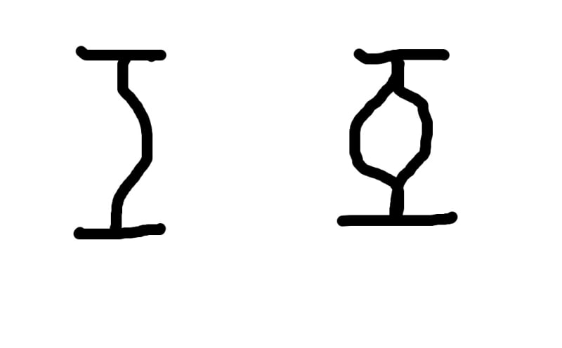

My concern is as below (crappy iphone sketch..). The left hand side shows the expected buckled web shape. The right hand side shows the two 4mm plates buckled independently at a much lower load than a single 8mm plate.
Agree with MIStructE_IRE that independent buckling would be a massive concern. You cannot simply plug weld the plates together because the resistance to buckling would put those welds in tension, which is something (at least for the Canadian welding standard) you cannot rely on them for. Plug welds are for shear only.

I do feel that plug welds could be used for this purpose. There's a precedent for it: that's just how we connect web doubler plates in the beam column joints of high seismic moment frames. There would be a tension demand on the welds in some circumstances but, perhaps, a fairly nominal one.
