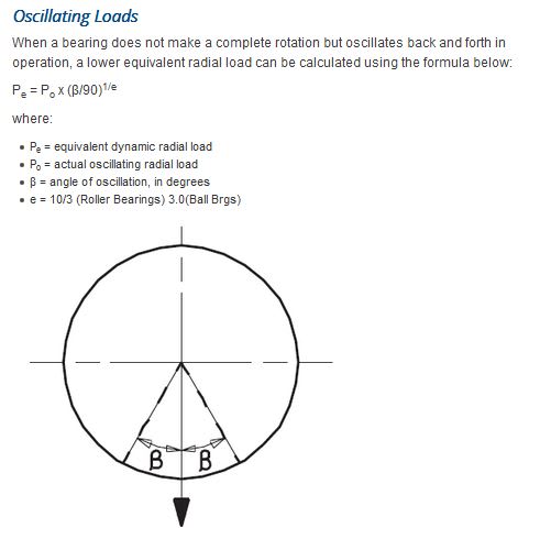

The static load rating on the bearings is related to the number of rolling elements and their contact area. Switch to a roller bearing of some sort for a higher static capacity.
also, there is a re-rating possible for oscillating loads
