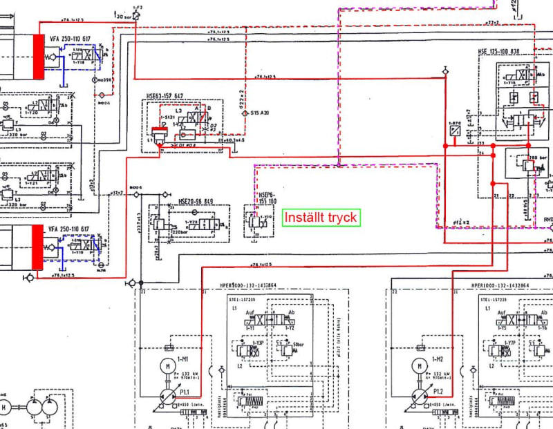

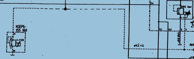

It is actually a pilot valve for the real pressure valve(260bar) which has a working pressure between about 30-252 bar.
The pilot valve in question is 1-Y30 HSEP6-155 160 (max 315 bar)
My assumption are that it to has a working range P between 30-252 bar and on the other side T against the tank my assumption is that the pressure is 0 bar ?

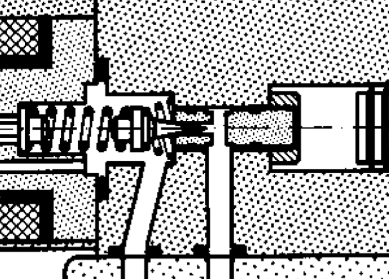

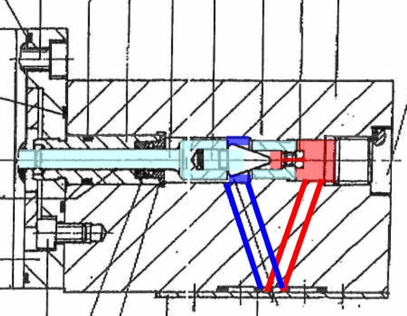

You are correct that T is 0 in your drawing. However if T is anything but 0 it simply adds to the opening pressure.
I am looking at your valve drawing to understand the purpose of the orifice.
If I had to hazard a guess the orifice sets the minimum flow rate through the valve when it is the shut position. Once set pressure is reached, the valve becomes proportional to maintain the set pressure value and will vary flow rate as a result.
I posted this image in your other post. It shows the cone valve in more detail. This one does not appear to have the orifice. In your case the orifice would appear to limit the maximum flow.
Well as I se it all oil have to go through the nozzel.
First it has to pass the nozzel and then the valve cone.
If I put max power on the coil the valve cone is shut, no oil goes through then I have 260 bar at the combined safty and pressure relife valve.
And if I set 0V (ca 0 Amp) it is open, it drains out all oil. pressure is drops to 0 bar at big valve (260bar)

I will try to explain the function as I see it.
BTW I do have had 80 hours of basic hydraulic practical and theoretical education but that is aged ago and all my books are at work..
My first thought was that it was a ordinaire pressure relief valve but since it does not seems to have a spring !?
I think the function is that I adjust the flow rate over the cone depending on how much it opens or closes building pressure at P. So it is actually more of a proportional "flow" valve.
In the data for RS416 I saw that the flow over the valve must not be less then 2 lpm.
If I would put OV or at a power loss the pilot valve (RS416) will be opened by the pressure in P and when the pressure drops this opens the 260 bar valve that we call "Kalle" in English it's the same as Charlie :-)
When Kalle opens all the flow from the pumps (2100 lpm) will go over Kalle directly to the tank which makes the pressure go 0 bar at P on the pilot valve 1-Y30 (RS416) since the pressure at P comes from the main pumps via Kalle.
So if you put in a valve with max flow 5 lpm I believe what will happen is that Kalle will open much faster with a hell of a bang, it is not very quiet when it opened to day either, it might not go 4 times as fast but it wont be good for the equipment.
Or am I wrong?

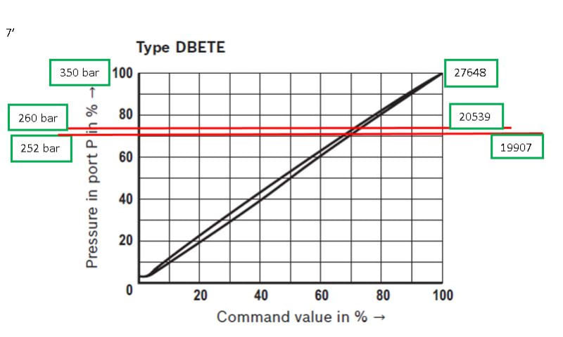

And the pressure regulation will be less accurate with the 5 lpm 350 bar.
Today I have 315 at 27648 with the 5 lpm I will have 315 at 19907.
And we don't want more out then 265 bar, that is for adjusting Kalles safty spring (260 bar)
The press only uses 252 bar.

With Normally there is no jet upstream of the needle. do you mean with no nozzle ?
With Without any effort on the needle. do you mean fully open?
Best Regards A
Albert Einstein
With Normally there is no jet upstream of the needle. do you mean with no nozzle ? Yes, if we want to have the maximum flow, why add a nozzle in series?
With Without any effort on the needle. do you mean fully open? Yes
