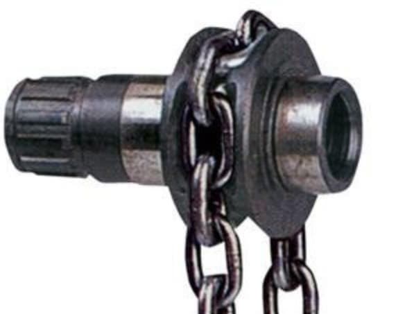

I would scrap that clap-trap and either loop the chain over a small diameter chain wheel back onto itself or clamp it in a two-piece chain block. I can’t find an image of a chain block, but am attaching a nifty view of a chain wheel in case you’re unfamiliar. Chain blocks have similar geometry supporting the chain, but completely surrounding the chain and split/clamp/bolt down the middle.
