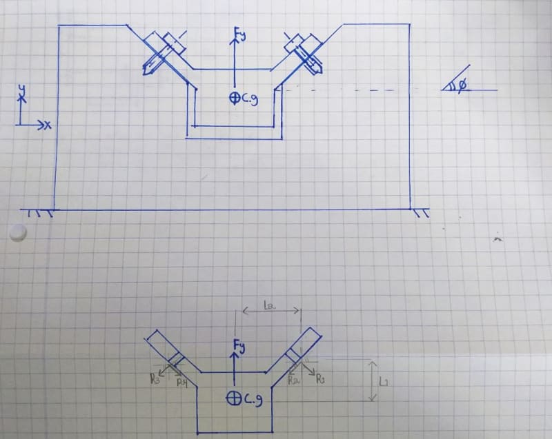

hello everybody,
I graduated long ago, and I am trying to figure out how to calculate reactions in bolted joint, so I will be able to know what is the external tensile load on each bolt and in addition the shear force that is actually the outcome of a friction generated by the pressure the bolt exerts.
I am trying to draw a free body diagram of a quite simple problem, but I find it difficult to solve since there are only 3 equations and 4 unknowns.
when I try to assume that as a result of symmetry the right reactions = left reactions I get a contradiction while formulating the equilibrium equation in the X direction.

Hi eli28
How are the external loads applied and where on the diagrams? Also include the magnitude of the the external loads.
When the bolts are tightened up the friction generated between the two clamped faces will depend mainly on the bolt preload and the surface finish between clamped parts as well as a coefficient of sliding friction.
How rigid are the flanges? If (just for a moment) you imagine their connection to the central component to be pinned joints, does that affect your view of the problem (or is it a more academic exercise than that)?

hello everyone and thank you for replying.
I am going to answer each one of you in this post.
BrianE22
I initially thought exactly like you - that I have to automatically write down the friction as mu*R1.
But I am not sure this is true since this expression (mu*R1) is the maximum static friction that can be supplied and not necessarily the existing one.
There might be 2 cases (I am interested in checking the 2nd one):
1. there is a much more lower friction than mu*R1.
I attached a file from a mechanical engineering book with a solution to a different problem, and there you can see that they don't take the friction (Fc2y) to be automatically equal to mu*Fc2x.
In addition, when you take their answers and divide them (Fc2y/Fc2x) you get a small fraction (0.03) that is probably not the friction coefficient.
2. there is a need in much more higher force than mu*R1 for achieving an equilibrium.
In such case the bolt preload is insufficient for making enough friction and we should add pins.
what do you think? is it right?
Thanks!

desertfox
The external load is indicated in the sketch as Fy, and it's a force that pass through the symmetry plane and c.g.
I need a solution that uses parameters, and that's the reason I didn't add a value.
Please see the answer I gave to BrianE22 regarding the friction force.
I will be happy to hear what you think about it.

Hi eli28
Yes your problem is statically indeterminate, however you could get some idea of the axial loads in the bolts by drawing a triangle of forces diagram using Fy as the vertical force and draw the lines of action acting at ninety degrees to the angled faces and close the triangle, if the bolts are symmetrical about the C of G where the load acts then the reaction in each bolt would be equal in theory. Once I knew what the load was from the triangular forces diagram I would size the bolts with a good margin of safety, my solution isn’t perfect but it’s a starter for ten👍😀
there's no applied Fx, the load/reaction system is symmetrical. So the two reactions, the two vectors at the two fasteners are mirror images.
what this means is that R1 = R3 and R2 = R4 (since they've been drawn sensibly mirror images).
the free body diagram is a triangle, an isosceles triangle, with the two faster reactions being vector summed to the applied (vertical) load.
what this means is R2 and R4 are not zero, but equal.
yes the problem is redundant, but we can makes some conservative guesses about friction to solve it without complication. mu = 0.1, 0.3, 0.5, 1?
as desertfox said, design it with a large MS. I suggest the actual mode of failure would be the failure of the heads, being pried off, which is a whole different thing !

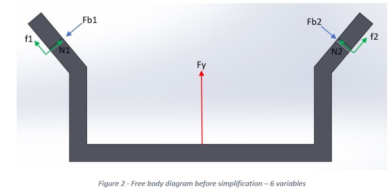

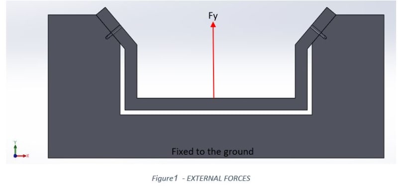

Here we can see the original problem with the single external force exerted on it.
Here is the most detailed Free Body Diagram before starting to simplify and omit variables.

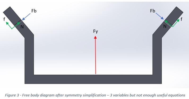

First quite simple and intuitive simplification is assuming symmetry, so all the reactions on the right side are equal to the left reactions. Now we are left with 3 variables, but when applying 3 equilibrium equations we find out that one of them is useless (we get 0=0).
The second assumption that we are forced to take is that the friction is quite negligible as some of you already wisely suggested. Now we can say that we have resultant force that we call p=Fb-N, and now we can solve the problem. After we find P we can find out its 2 components N (the axial compression force of the clamped members) and Fb (the axial tension force of the bolt) from calculating their relative rigidity as described in any design book in the chapter that deals with bolted joint.

1) the problem is not unsolvable ... if you can define the friction (if you want to account for it)
2) why neglect the simplest reaction ... Fy/2 vertical at both fasteners ?
3) Figure 3 has two unknowns (N and F) because you've applied symmetry. But because you've applied symmetry you can't determine from statics these reactions. But you can solve the problem with other analysis tools.
You will have non-zero moment reactions at the bolted connections. I don't see those on your FBD.
Hi eli28
Glad you got it sorted and yes I agree with your figure 4 diagram, which is what alluding to in my post👍
