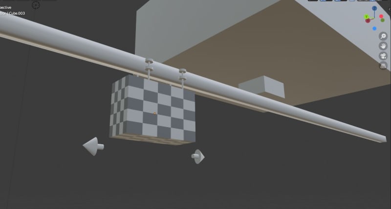

We need to design a device that (among other stuff) consists in a box running back and forth along two rails, which needs to have a bar, underneath and across it, and in this bar there should be a device that has to slide left & right using probably 4 small wheels running inside a slot in the bar.
This bar should be 3 meter long, and the device sliding along it should receive power and data (at least 4 wires in total) to it, so we need to find a solution to run these wires that allows free movement left & right

Yes I understand a skecth would help on this

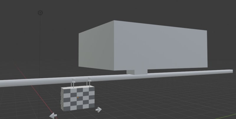

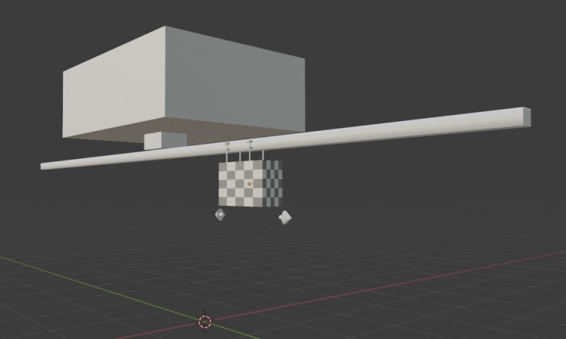

I made a really quick and dirty draft of what I have in mind.
The "checkered" box has to travel back and forth along the long rail.
I understand I would have to get both the flex wire and the cable carrier arms, but I still don't see how this would attach to the rail. I mean, while the moving box it at one end (remote end), how would the carrier remain stuck to the rail, instead of being loose? And while the box is at the other end (near end) how would the carrier remain all flexed and collapsed so it's not hanging all around?

All cable carriers have a fixed and and a moving end. The fixed end is normally where all the conveyed utilities (power, signals, air, whatever) enter the carrier. There is no relative motion between that fixed point and the entrance of the carrier. The moving end is attached to the carriage, so that there is no relative motion between the exit of the carrier and the carriage. You must have solid connection points at each end of the carrier. Depending on its length and design you might also have to provide intermediate supports along its length. I strongly suggest you contact technical support at each of these companies, describe your situation, and let them make recommendations. They can also provide you with sample applications to give you a better idea how its done. That's what they are there for.

I checked those festoon systems and from what it looks it takes some space between the carrier rod and the moving box, and in our case we are very limited right tnere. We have more space sideways (ahead and behind) so that's why I believe that some system that flexes in several segments at one side would be better.
