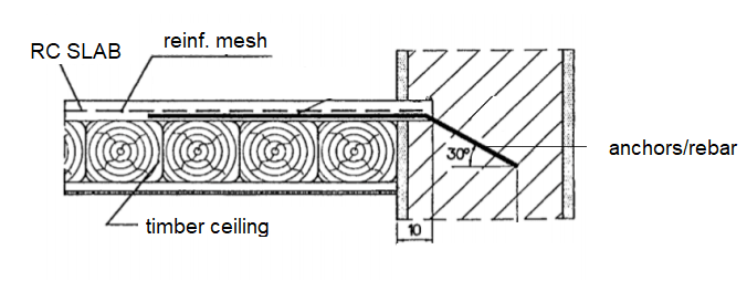

Timber beams 180 x 240 (no spacing between), on top plywood and RC slab (70 mm thic). Connection between slab and timber are nails as shown bellow.
How do I calculate shear capacity per 1,00 m (kN/m) for such composite ceiling?

It's a common thing when reinforcing old structures with timber ceilings.
If old / existing timber beams are in good/acceptable condition we make composite ceiling by putting screws (based on thicknes, material, span and loads for horizontal shear). And then pour concrete slab or screed on top with reinforc. mesh for crack control. Slab is also anchored in bearing walls so it connects bearing walls (acts as diaphragm). It's not what I would do for new structures but it's a common thing for old buildings that are not allowed to be demolished.

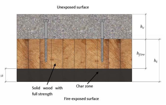

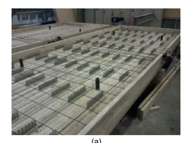

Composite, topped mass timber products are a pretty near analog to this. A relevent design guide, shown below, can be had as a free download. In it, they develop a shear methodology. As OP rightly surmised, much comes down to the flexibility of the connections. And most of the connections considered have been tested to some degree and are considerably more robust than conventional nailing.

They seem to be saying that the vertical shear that can be carried is either governed by the shear capacity of the interface, or the timber beam alone. So as people have stated, only the bare timber beam should be considered in the normal sense for resisting beam shear, but also just need to confirm you have sufficient shear connection to develop any composite moment capacity required (and the corresponding interface shear which is proportional to the beam shear).

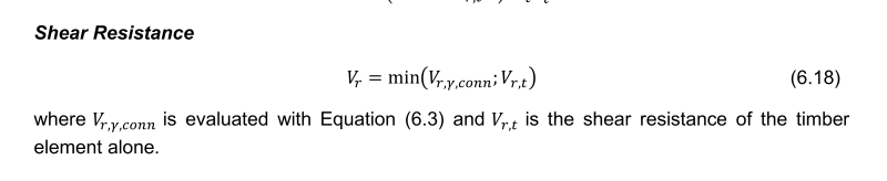

The text is copied from the guide for information. In which, the shear capacity of the composite is dependent of the shear capacity of the connection (shear flow), the concrete, and the timber, respectively.
The shear resistance of the whole TCC floor is reached when the first component reaches its
strength. Thus, the following equation gives the shear resistance of the whole TCC floors (𝑉𝑟):
𝑉𝑟 = min(𝑉𝑟,𝛾,𝑐𝑜𝑛𝑛;𝑉𝑟,𝛾,𝑡; 𝑉𝑟,𝛾,𝑐) (6.16)

Section 2.3.5.2. A conservative approach to evaluate the shear resistance of the composite beam
is to neglect the shear force taken by the concrete slab. Consequently, the shear resistance is
evaluated with the following equation:
𝑉𝑟 = min(𝑉𝑟,𝛾,𝑐𝑜𝑛𝑛;𝑉𝑟,𝑡) (6.18)
It seems to me that they're only saying that for negative moment regions, and for obvious reasons. It appears to me that, for positive moment regions, they are allowing composite behavior to improve shear capacity. I've only really skimmed this document so far, however, so it's entirely possible that I've missed something.
From a mechanics perspective, we know that horizontal shear and vertical shear are complimentary. In that sense, having the gain in horizontals shear pretty much guarantees also having it in vertical shear. That said, a little extra conservatism in the vertical shear is understandable if that's the story that we're telling.

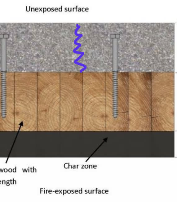

So what would a shrinkage (or other) crack here do if we were reliant on the composite section for vertical shear?
1) Nothing so long as one of the following is true:
a) the shrinkage crack is small enough to not compromise aggregate interlock shear capacity and/or
b) the governing shear failure mode occurs on a diagonal plane rather than a vertical one.
2) In my mind, with proper connectors, this is fundamentally similar to these two situations where we normally do allow for shear enhancement as a result of toppings that will have restrained shrinkage cracking:
a) composite concrete slabs cast over metal deck and;
b) composite topping slabs cast over hollow core plank.
