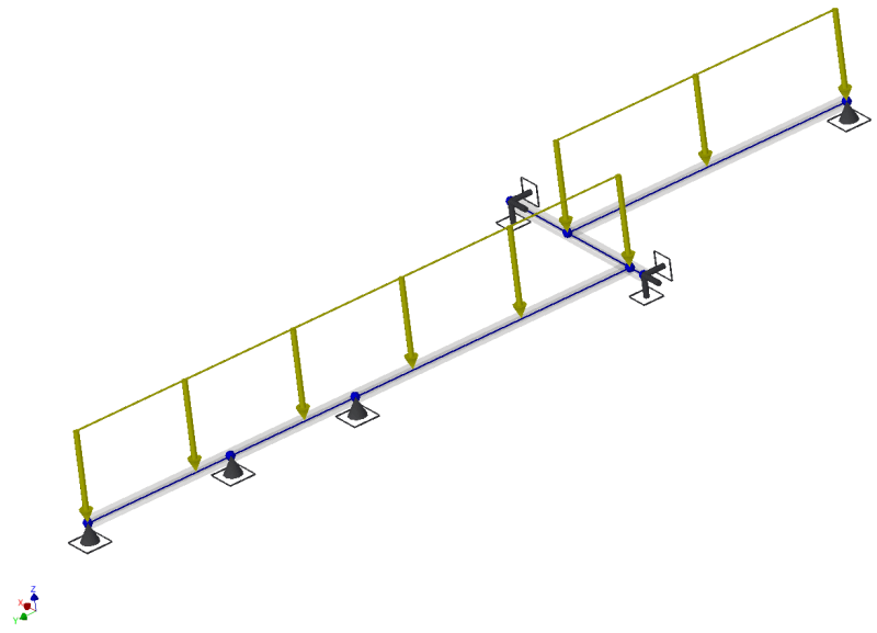

Sorry! I could have supplied more information:
- I'm located in norway (Eurocode 3)

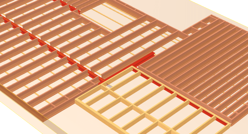

- HEB140 to carry weight of floor (2kN/m^2 * load factor), see picture below
- Maybe i'm overly conservative when assuming moment connection?!
- My reason was to ensure proper bolt size and grade (pending calculation). With the moment acting as a couple
- Calculating bolts based only on shear seemed...too simple

There is some moment induced in the connection due to eccentricity, this may be what you are referring to.
The connection itself is quite 'flexible' and would allows some rotation hence it is typically treated as a simple pinned connection with no moment transfer from the supported beam.
Almost every structural joint will have some moment capacity, but it is usually ignored in the analysis, as the not very meaningful moment can be relieved through the flexibility of the simple shear connection, if the entire structure is stable.
As noted above, this is a very standard double cleat connection. Assume pinned ends / no moment at the connection to the supporting beam.
Typically I would assume the 2 bolts between the double cleat and incoming member are subject to a bending moment (due to the end reaction x offset from CL of the supporting beam to bolt CL) and shear (due to the end reaction), and act, if you like, as a continuation of the incoming beam. These will be in double shear for a double cleat.
The 4 bolts between the double cleat and supporting member are subject to single shear (due to the end reaction).
The backing plate does not allow for double shear in the bolts (it's loose usually) and is usually provided to stiffen the supporting beam's web if bolt tension (due to any axial load in the incoming beam for instance) is causing web bending. In some instances the backing plate may be welded to the supporting beam in order to improve bearing length for the bolts, but I don't see that often.
