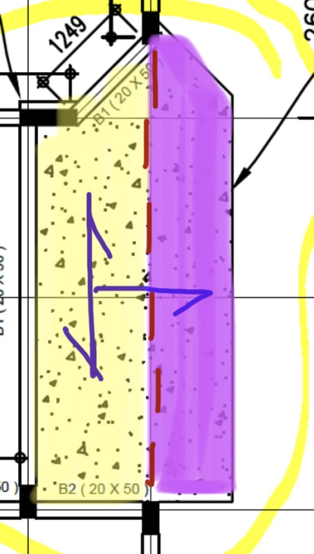

I’d be surprised if you couldn’t get it to work as shown below by hand.
Hopefully my crappy sketch is self explanatory.
Ps - the dashed line isn’t a beam. Just a delineation between two slab span directions. It would work with an FE analysis in my view.

@MIStructE_IRE: You mean design the yellow slab as 1-way (North to South) and the purple would be cantilevered off that slab?

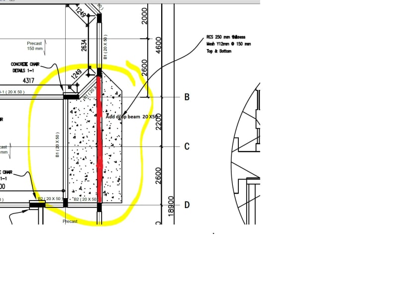

SDL = 3 kN/m2 so the total DL = 0.25*25+3=9.25 kN/m2 is this true ?
My suggestion will be use drop beam and reduce the thickness of cantilever to 150 mm. Proposed beam shown with red below..
