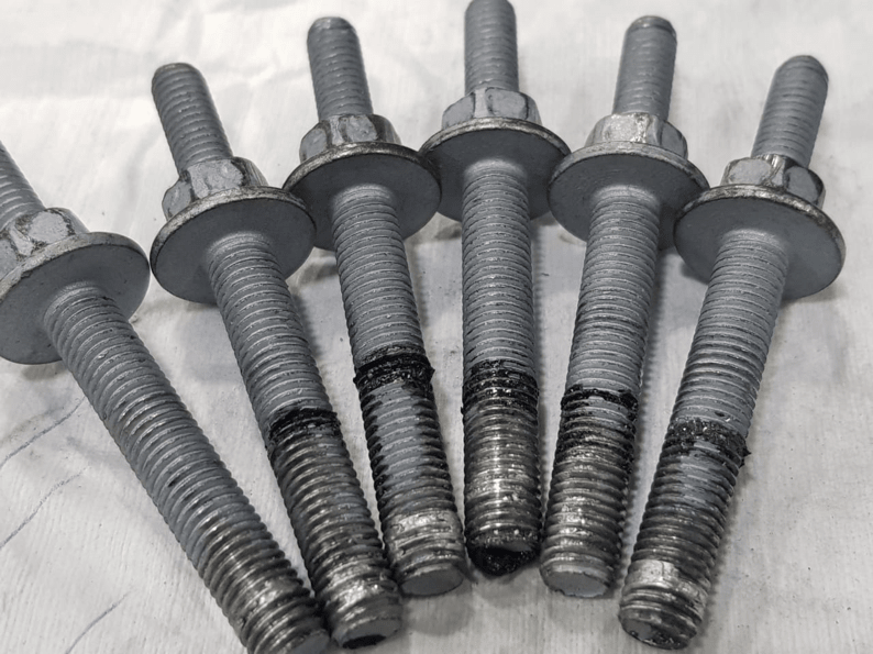

According to the information I had review, we are suppose to be forming the threads on the bore (These are machinned and the material is Aluminium) but when I remove the screw I see material from the bore literally welded to the Edge of threads, meaning I'm cutting instead of forming.
Here's a picture of the threaded bolts torndown. (The black things is just sealant from the joint surfaces to clamp.)

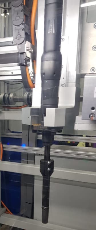

This is a photo of the equipment used to install the screws. We use an atlas copco nut runner mounted on a CNC.

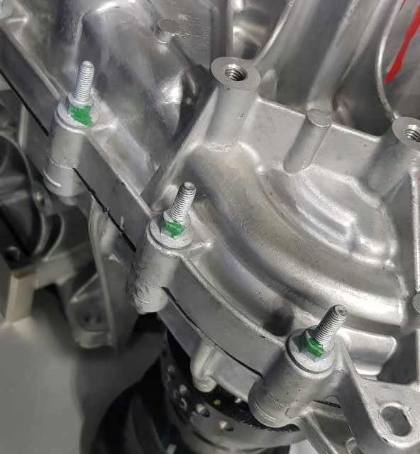

This is a picture of the part seated on a pallet, later to be processed on the station (I'm showing the bolts where we have higher ocurrance of screws not fully seated.

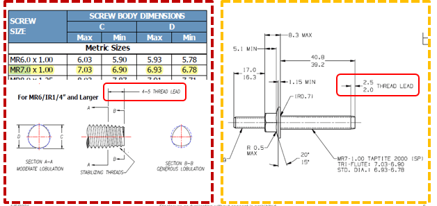

Making a comparison from Conti-Reminc data sheet vs the Internal drawing I have for these parts. There's a difference on the spec (Thread Leads), since the dimension suggested for a MR7 is 4-5 Threads and the internal drawing only marks 2-2.5mm of thread lead (which it represents about 1-1.5 threads), don't know if these could be a variable that contributes to the failure.

The predrilled hole diameter needs to be larger to allow space for the metal displaced during threading with the bolt.
On edit: And add a lubricant.
Ted
hydtools nailed it, rolled threads require that the minor diameter for rolled threads calculated at a minor diameter before rolled or formed tapped.
to allow displacement of the material to the required minor diameter. a coating on the bolts would also may help for the galling.

We used similar fasteners. The holes that we drilled were oversized, and they also flared a bit at the start. Sometimes you get enough material displaced that if the top of the hole is tight it will prevent seating.
A lubricant is necessary.
Thread forming in cast material can be a challenge. Casting quality can make a difference.
