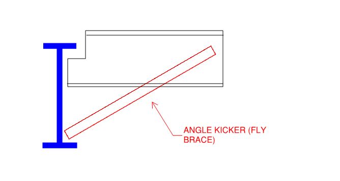

In the situation that you're describing I do not feel that it would be reasonable to incur a large weight penalty just to satisfy the [0.6 x T] psuedo-requirement. Rather, I feel that many engineers would attempt to accomplish the same thing with kickers installed to connect the bottom flange of the spandrel beams to the top flanges of the infill beams. It creates the same roll beam connection but, in some cases, at a lower installed cost. Of course, the kicker has to be palatable from a spatial perspective as well and not stick out through ceilings etc.
Where full height stiffeners are used in conjuction with a deliberate moment connection, that may well be an attempt to provide torsional bracing / capacity in a situation where diagonal kickers would be unacceptable. Appendix 6 of AISC SCM provides the requirements for strength and stiffness in such situations for the bracing function.
