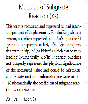

I have seen different approaches used and also note the units sometimes do not agree in the k value (some sources give vales per unit volume(kN/m^3), others are per unit area or unit length).

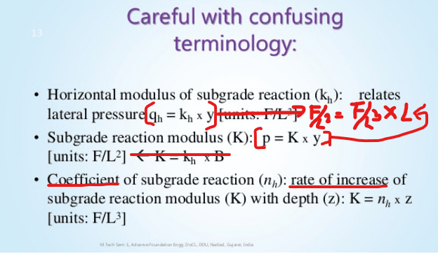

No difference in the end, as explained below. You shall talk to your geotechnical engineer for other questions.
The author has himself confused with inconsistency in the expressions. I am not aware the term "Coefficient of...", also I don't think there is any units associated with the "Coefficient" and "Rate of Increase", which are usually considered as numerical value only. I'll stay away from his article/book, as far as I can.
Further note:
For the second expression, I think he wanted to relate the vertical modulus of subgrade reaction, Kv, as "pv = Kv X z". Both Kh and Kv are related to the soil in interest, and should be provided by your geotechnical engineer.

Be cautious of a document that tells you that the "modulus of subgrade reaction" and the "subgrade reaction modulus" are different things. I would hit the delete button, personally.
Also, the original (Terzaghi) definition of "coefficient of subgrade reaction" is what that 'confusing terminology' document referred to as k_h (ie coefficient = modulus; two names for the same thing). See Like r13, I think the author of that document is the one who was confused.
